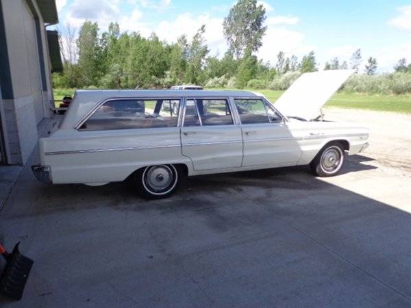

I am the second caretaker (I don't think I own this..as much as it owns me) of a 1966 Coronet Station Wagon. Bought the car 10+ years ago from the estate of the original owner and has been stashed in the barn since. Got it out last summer to sell it....and that did not happen. So...putting it back to a driver, hopefully. Its an all original paint, Black-Plate, southern CA car (one quarter looks like something has been done), factory 9 passenger, 361 original. Last summer I started the process of cleaning it up and hopefully will have it on the road this summer. Yes....all you Hemi guys, it still has the 14x5.5 steel wheels. Which is why I have questions. I did convert the power drums to front disc, requiring a change now to bigger wheels. So, what will fit (assuming I would like to fill the wheel wells a bit more) and what makes the most sense? 15"? 17? Seems like 15" tires are getting tougher and tougher to find. Looking for some suggestions and pics. Was thinking American Racing Torque Thrust II's? Maybe?

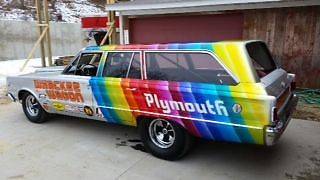

A plymouth but pretty cool.
15X10 Steel wheels on the back, torque thrust D's on the front.
... and a Big Blower, cage and mechanical tach up on the dash, some flames...
You get the idea,

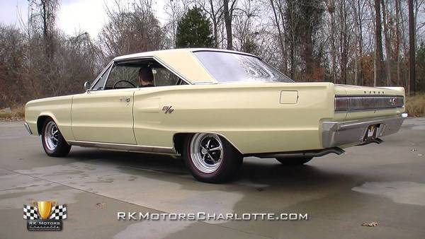

That wagon would look good with chrome Magnum 500 style wheels which would be period correct, and are available new in 15".

I went with 15" 235's on the back and 15" 215's on the front. I don't believe you can get wider in the rear without a possible rubbing issue. Mounted them on Magnum 500's.
