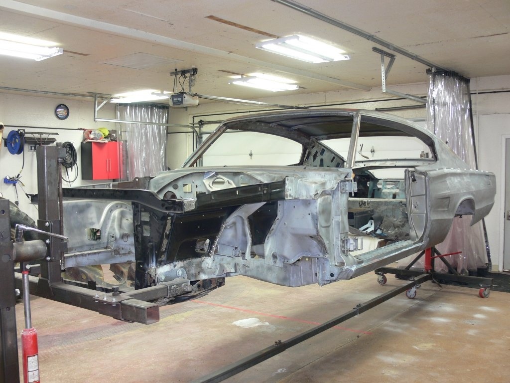

I have entire front end parts, going to upgrade my 66, so all of the NEW parts I have accumulated, are for sale..........for now anyway, as I have another 66 may keep it completely stock. But got to finish this none now. But all brakes are drum style.
