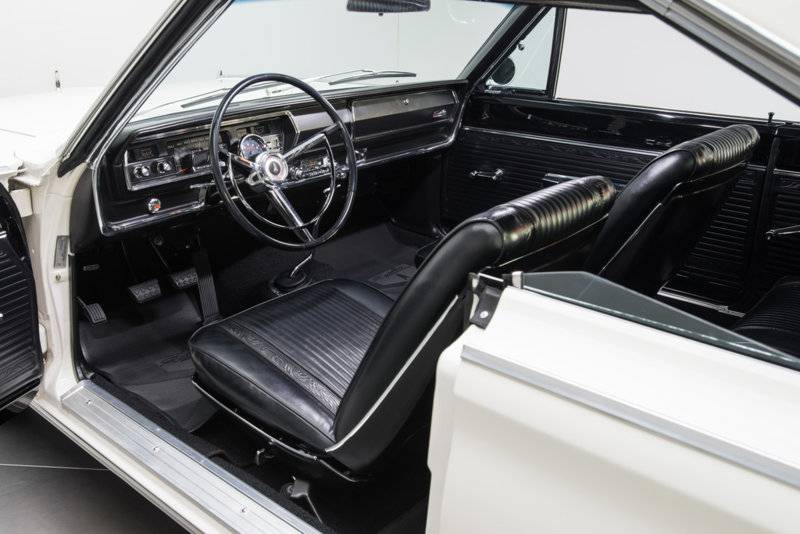

Hey guys, can someone tell me if the front seats on a 66 Satellite tip forward to allow access for rear passengers without disengaging any lever? Mine simply tip forward when pulled - I can't even see any locking mechanism.
The reason I ask is I'm just about ready to register the car and have started worrying about the lap belts only. The rear seat isn't so bad as I can fabricate some shoulder harnesses for the kids, but I don't want 3 point seatbelts up front as they are ugly and I don't want to remove the headlining to install mounts. I was thinking of some four point harness that attached to the back of the seat itself and tucked away out of sight when not in use, but that isn't going to work if the seat back just flies forward in a collision. Surely they would lock somehow?
The seats are as per the attached pic (not mine unfortunately)
I do not remember any locks. Lap belts only. Shoulder belts where an extra. Remember 1966 was the first year seat belts were required in all 50 states. The bench seat satellite was considered a 6 passenger vehicle. With buckets 5 passenger.
Had buckets from a 66 300 in my bel still no seatback lock.

Yes the seats just fold forward when pushed, no locking mechanism.
Yeah the latches came out later 60's I have none in my '63 Plymouth convert. I added headrests to the buckets as I've had neck surgery and doc says whiplash could be a real bad thing for me. Added rear seat belts. Funny story related to no seat latches: My dad took me out to practice driving in mom's 60 T-Bird. They had buckets no latches of course and he made the mistake of sitting in the passenger seat angled toward me so his arm was over the seat back with his other arm crossed over holding his upper arm for support. Well I hit the brakes pretty hard and he ends of banging his head on the dashboard when the seat back flipped forward...yeah those latches were a nice addition!

67 Charger, same seat. I have never seen a lock at all. Rears lock though (buckets). Same rules in Canada, if it’s stock it passes. Sometimes it’s a very liberating feeling, but in a real accident, it would be a poor outcome. A friend’s 64 Polara has no rear belts (stock). Legal, not what most would wives would like to see for belts for their kids. But as kids we rarely wore belts on long trips- especially in station wagons!

yes a panic stop in a stock 66 will tip an empty seat back forward
