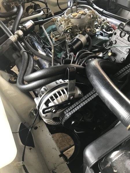

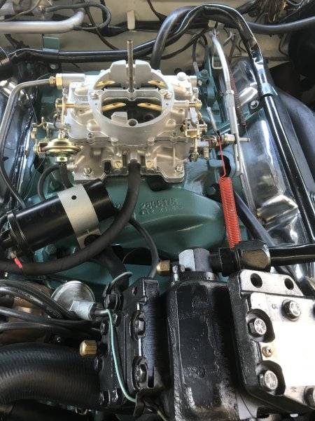

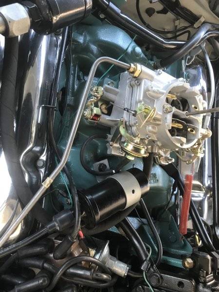

Looking for some detailed engine photos of a 67 R/T or GTX 440 with factory air. I had a mishap and lost all my photos from the disassembly stage of my motor and life got in the way, 18 months later I’m getting ready to reassemble the engine and could use a guide
To where the brackets
Mountain, the exhaust shields go and the plug wire looms etc..
My car actually has a 68 motor in it and a 69 AC compressor. But for any help it can provide here are a couple of pictures. The idle compensator and master cylinder are not stock. Ignition wire looms are hard to shown on these engines.

Hi AR. Great pics. Thanks!
