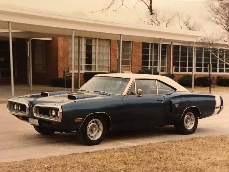

Rear axle and springs in my '69 Bee are out '67 Charger. Blew the OE in '79 and it was the closest I could get for an even weight swap at the junk yard when I was 17!
