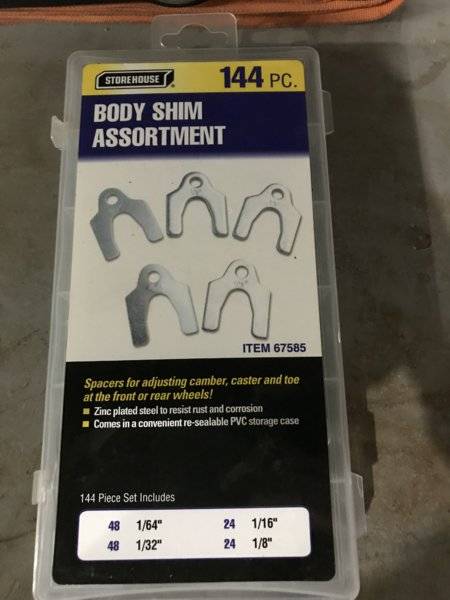

I used harbor freight fender spacers from a kit I bought there. They are the perfect u shape to fit over the end of the defrost vent and have the right size hole on the tab. It is if they were designed to fix this issue.
Do you happen to know the item number of this kit??
Item 67585
Dude!! Right on!!
