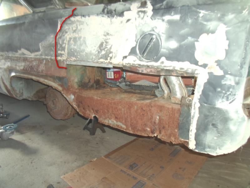

I was wondering if making a template the shape of the side would be a good idea for doing body work and pounding out some dents of my quarter panel and welding in new pieces.There is some good dents along this section and I would like to try and get it so it turns out uniform along the side.

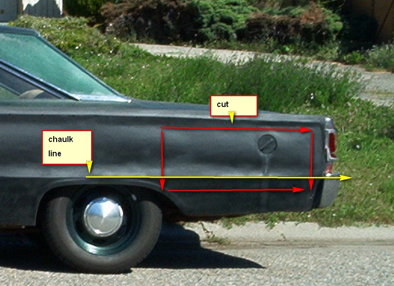

just my 2cents, drop the fuel tank if your have not yet, pull the fill tube, cut the fill hole out of that qt leaving aprox 3/8" of metal all around it. rebuild the inner panel with a new piece , redo your spot welds to the trunk floor to re hook it , now cut the rest of that mess up to the upper body line about 1/4" under that line , take it {the cut} forward to the vertical line up with the rear of the wheel arch and then back to about a inch ahead of the tail lamp pocket. buy a sheet of flat body panel steel from keystone ect. barrow or use a metal break to crimp your lower body line along the full patch you cut.
under lap that piece with the top cut and hold in place with clamps , snap a chalk line to get your lower body line marked out for the metal break. trim the piece into place while clamped in.
tack it in a few spots and then cut and build the wheel arch piece.

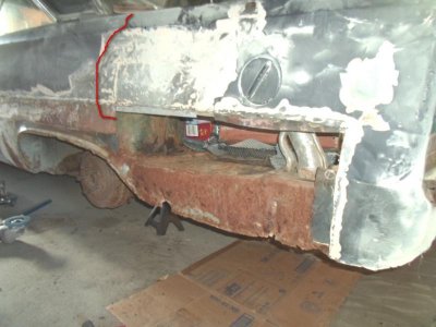

short of finding a good used qt to patch with I think you need to remove all that damage. once you get to dolly and hammering that its going to get all oil canning on your , prob is already from prev repair.
if you work with whats there you will have a 1/4 inch or more of tiger hair & filler on that panel to ever get it straight.
I know it sucks but in the end your will have a better panel to work with and a lot less filler, take your time and don't be worried about a screw up or two , the panel sheets are pretty cheap, just don't weld it home until your sure.
yes sir, but right on down to the bottom were it meets the inner panel , then start be replacing that inner 1st , the build your large panel , cut in the gas filler after all the rest is tacked in place, I know, you will have to bow the large panel to follow the body curve.
Mabey its just the pic you posted but the upper looks pretty ruff above what you have removed already, the more clean smooth steel you have there to work with the better your panel fill job will be.
Best way for sure would be to locate a decent qt but those are like hens teeth.
When you stitch that panel in take your time and move around with your welds , let it cool, don't warp it,
seal the back side with seam sealer once your done to keep it dry.
chaulk line the new panel once its clamped in place just for reference when placing in the metal brake. use a barrel ect laid on its side to get your upper outward bow started on the new panel.

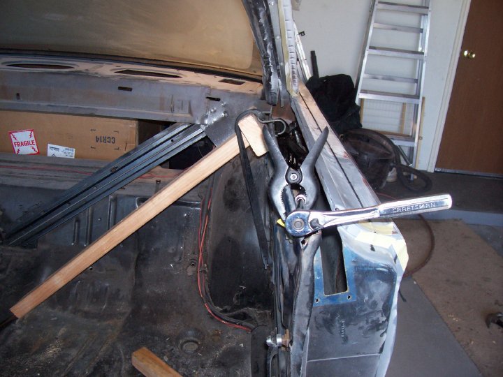

fun metal working, used a jack on the inside to work out a dent. that area is tough to work out because of the compound radius. I probably would have saved a lot of time and frustration just replacing the entire panel, but where's the fun in that.. looking good!
