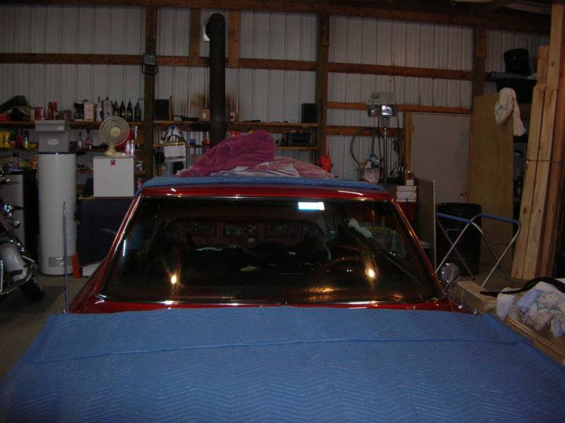

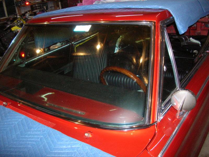

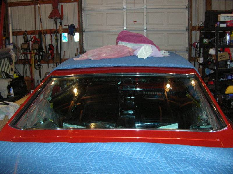

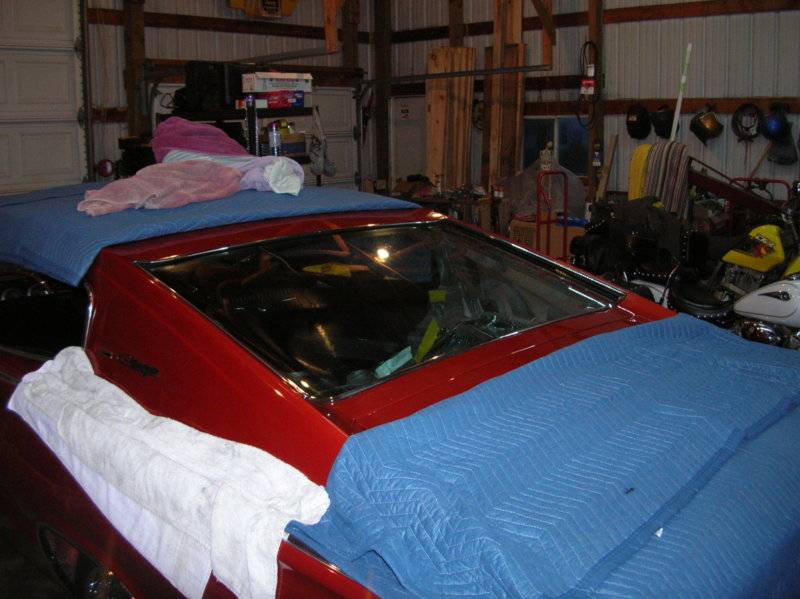

View attachment 606193 View attachment 606194 View attachment 606195 View attachment 606196
I hate you.
I assume it did not leak?
Did you use 3M 8509?
That back is short as well.
I had to put poly sealant on the inside when installed.
I could see daylight at the lower corners.
The guy who did the install has done this as a profession for 30 years. He is old school when it come to the old rides. The adhesive used is what he uses for older cars. I will find out what it is and post it. I worked on getting the interior back in place late today. Hopeful to have the panels in place by Friday....so I can take it down the road with the open headers...lol
picture is before glass
Carl
