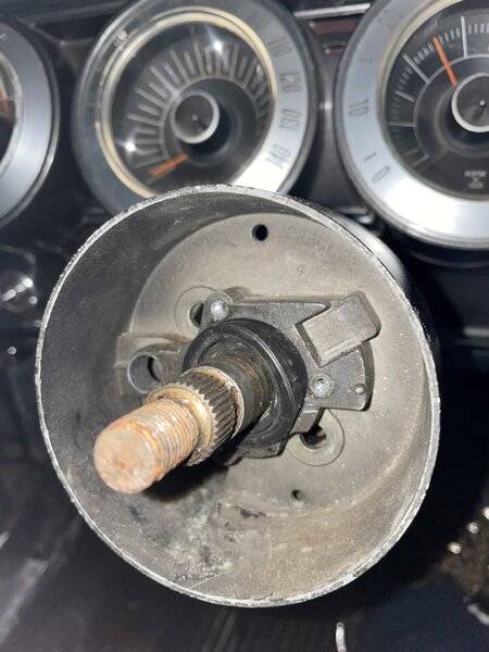

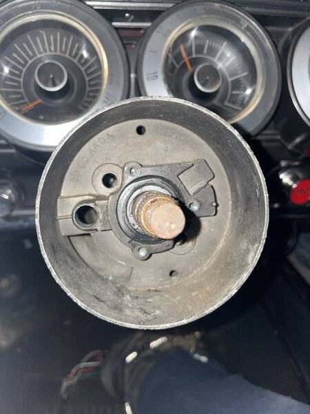

I just uploaded pictures of mine. The only thing I removed is the switch. I don’t have those two bolts/nuts
31DC2C86-97A1-4994-8417-C1D9B8C1D485.jpeg 5E471D73-038D-4284-8DD1-84C666048260.jpeg
View attachment 1205221 View attachment 1205222
Yes, you should have the piece of metal around the shaft that is held on with the philips head screws, the 2 screws are not in there right now. That is the piece that needs to be centered.
Ok cool. What about the two bolts/nuts in your picture? At about 1 and 7 o’clock. Just trying to log all the things that aren’t right. Thanks for your help!

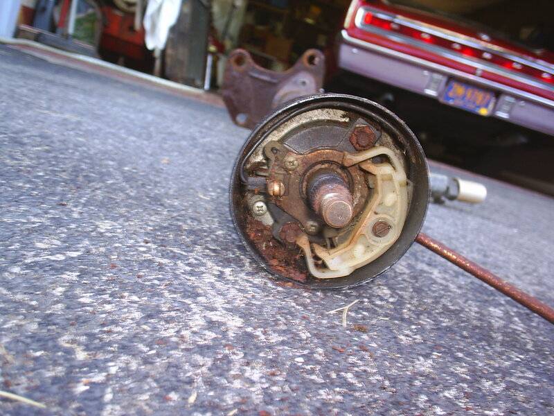

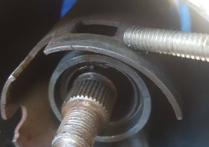

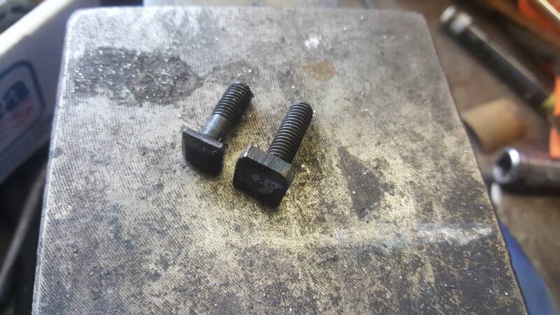

Those two bolts are the ones that keep your 'bell' from spinning. The distal end of those bolts is square so they are a bit special. Its a bi### to get them just right. I believe they are friction fit or catch the square holes in the 'bell' to secure. I made some that had a bigger head to catch that 'bell' hole better. Here is a picture of the made bolt and original and the hole that I think they catch.
EDIT: This is pictures of an A body column. I forgot where I was.

Yeah I have the little metal plate but I thought the same when I saw other pictures-seems like I’m missing some stuff. I actually have another column that I bought a while back off a guy who was parting a car out and it doesn’t have the two bolts/nuts either. It is exactly the same as the one in my car. And I’ve never had issues steering some I’m more confused than anything as to why two different columns have the same issue. i did find that when I rotate the bell it reveals a large set screw— what it does I don’t know either .
