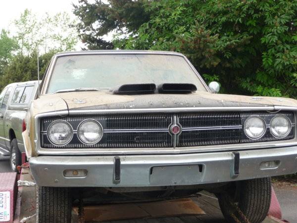

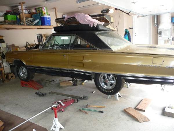

I have a 67 Coronet 500, 426 hemi. The last owner sawed off the leaf spring perches. I need to find out what the factory degree angle is so I can weld the new ones on. Does anybody know what the stock factory angle should be on the Dana 60?

Found it in a barn while garage selling in Bellingham Wash. been sitting for 35 years. What's really nice is the block has never been bored, worst cylinder was .003 over stock others were .0015 and the block is unstamped, probably an over the counter purchase from a speed shop back in '67.
Nice! used to date a girl from Bellingham when I was at Ft Lewis in '80-'81.
