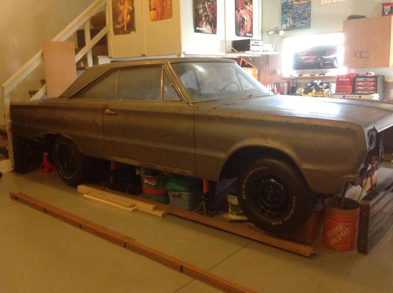

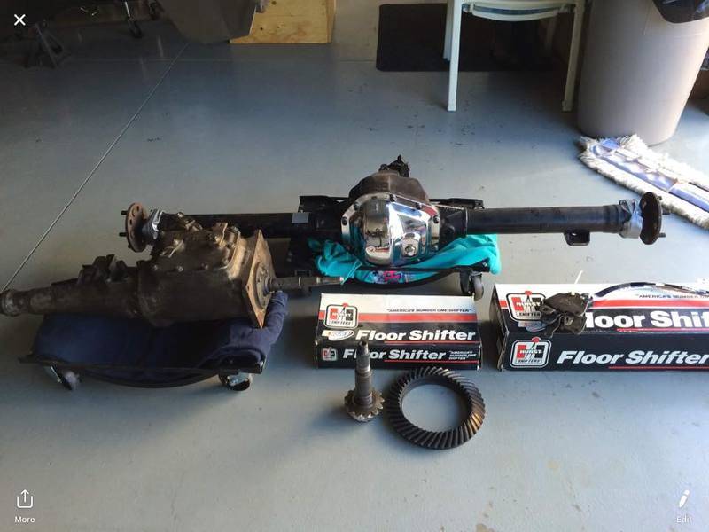

I looked at your post, I can't go much further as I don't do Facebook, but I agree the project is worth the money. Condition of engine and transmission wasn't stated, just that the front suspension is done. Another question is what year Dana, there isn't a good enough picture to tell if it's a converted truck unit or not. Looks like extensive quarter work needed. If the extras are listed I cannot see them. It's quite a hike for me. I have my doubts about the underside being completely rust free, looking at the passenger quarter. I would think outer wheel houses and trunk drops too, and as you know quality parts aren't available. Note that it's a Satellite so end value is not going to be in the GTX range. To part out, a lot of work in disassembly and packaging for shipping, but some money can be made in that direction.

The part of the chassis being undercoated would turn me away.
I inquired on a 67 Charger 4 years ago. Owner said it was free , and a 12 hour drive to look at it. Well from the time I talked to him to going to look at it. There put so much undercoat on. It was dripping on his garage floor when I pulled up to his driveway. Problem was he didnt fill the rust holes under neath.

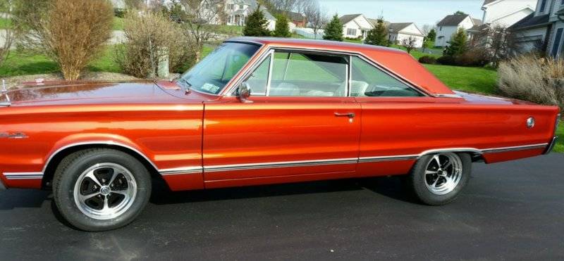

But a 67 Satellite with a console is a very nice car.
My brothers really nice:

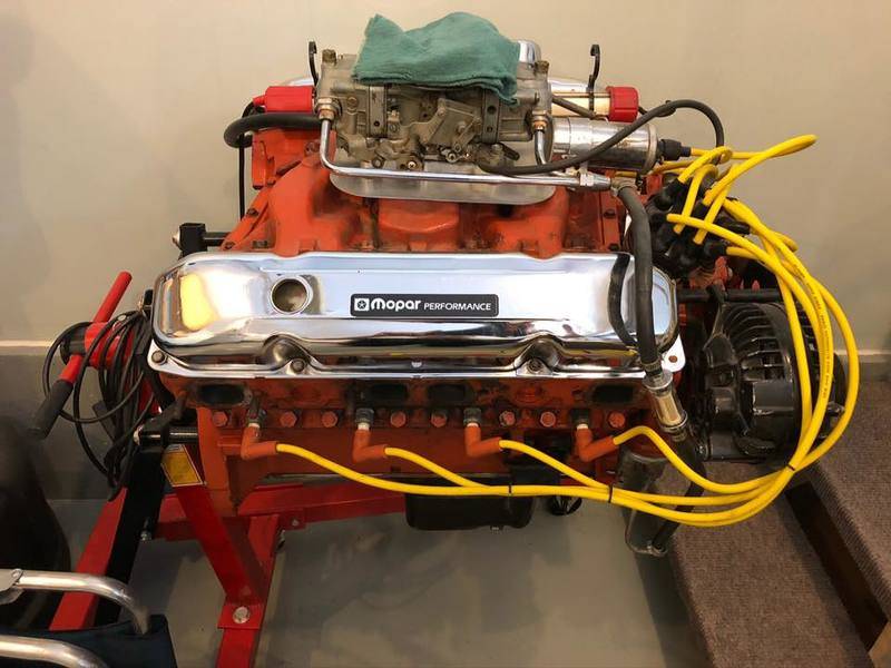

The repainted or rebuilt engine does not look like a 440... My old eyes don't see the large flat pad to the right of the distributor looks like a low deck engine.. Love the valve covers as I use them lots of room for rocker clearance... Interior looks like GTX/Sport Satellite interior and in great shape..

true enough. I had a chance to obtain a 67 GTX about 6 years ago. I knew the owners dad that bought it new. 12000 was the asking price for a good driving car. But it required rust repairs on the hind quarters and those aftermarket panels were always to short to make work properly. So I passed on that alone. Open it up and create more work.
IMO looking at the car how solid the fenders, doors, rockers, firewall and hood hinge area. I don't think it is a bad project and the price is fair. A good metal guy can work with those quarters and wheel houses..
Just gotta go look at it in person and see what's what. The Dana alone is worth some bucks especially if it's been rebuilt.....
