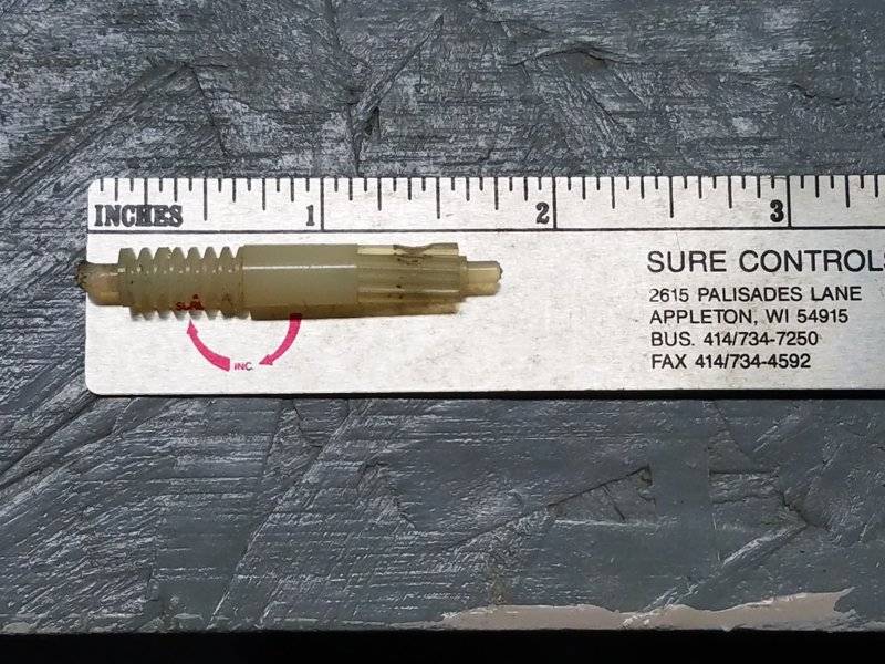

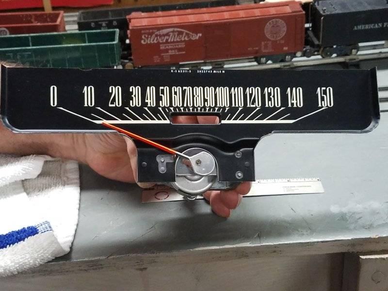

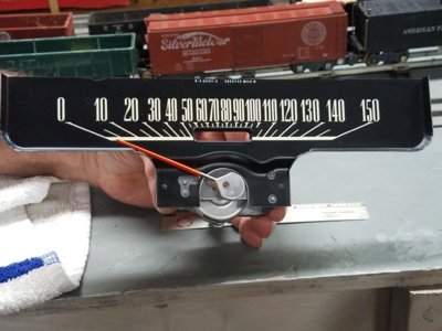

First ride this year in my '67 Coronet,all is going well,then all of a sudden the speedometer needle starts to bounce & its making a clicking sound,then the odometer quit counting.I pulled it apart and here is the culprit,you can see where some teeth are chewed up on the end of the plastic gear.My question is where can I find a replacement gear?

http://www.speedometersolutions.com/ This guy is in Milwaukee. I've dealt w him in the past on my E body. :thumbsup:
If its the same guy he's been there for ages.Good person to work with . He was the go to shop to get a work order saying our speedos were reading wrong , got me out of a lot of speeding tickets.
