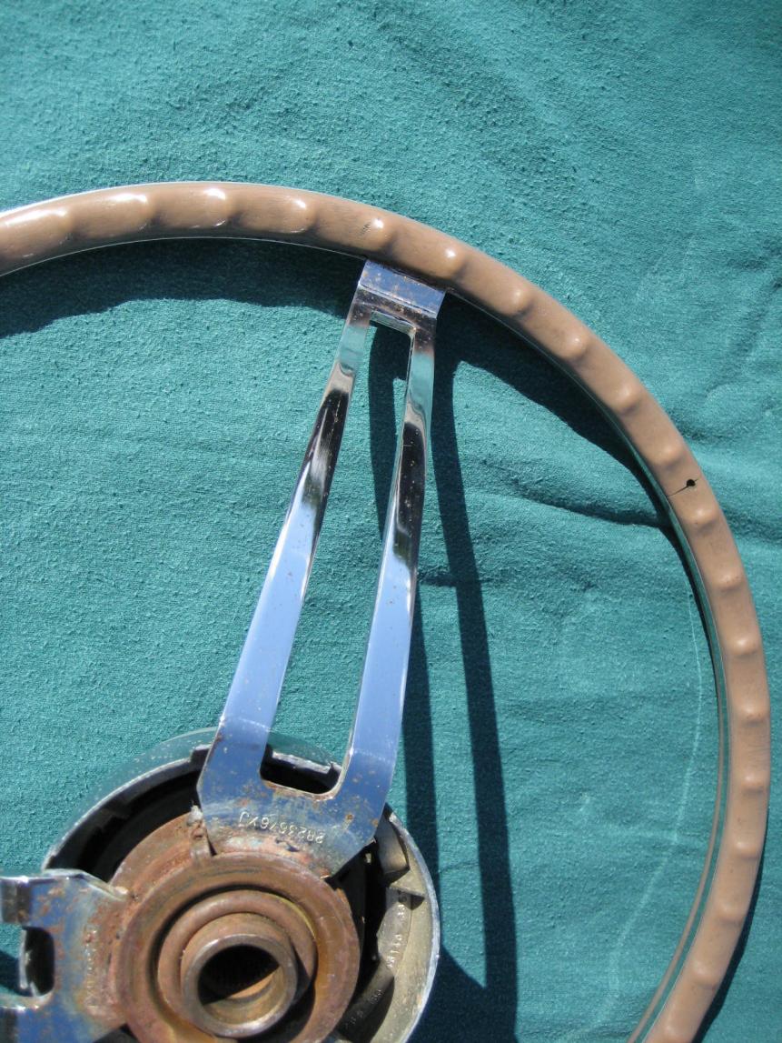

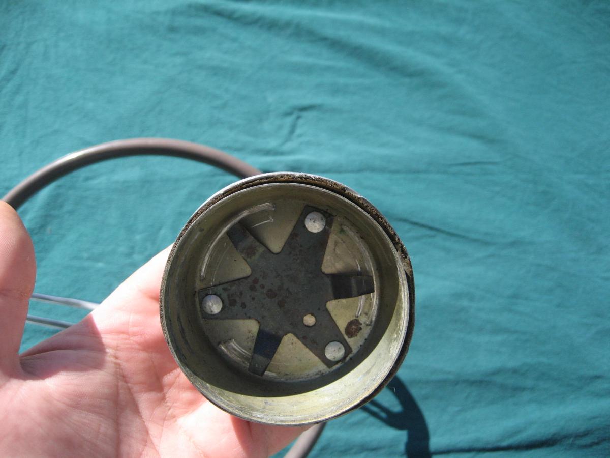

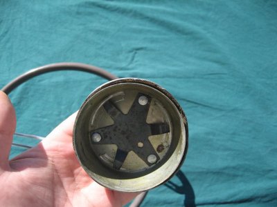

You can use a entire 68/9 set up, but you will have to use the pad also, I have done it. The 67 wheel is basicly the same as the 68/9 with open spokes. Here are some pic's of the one I had.
Good lookin wheel. Must be rare, I don't think I've ever seen one. Thanks for obliging me and posting the pics.

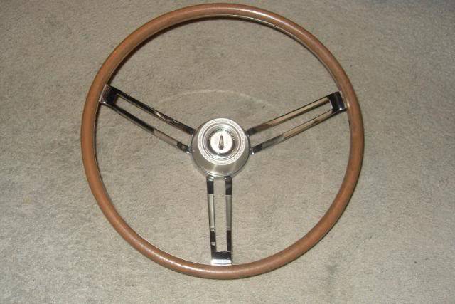

here is mine.
and no its not for sale.]
Sorry Bryan

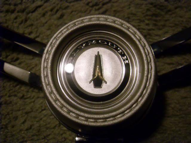

Here's mine. You can rarely find them on eBay. Whether they call it a recall wheel or not, I like the looks of it. It is going on my '67 GTX.
