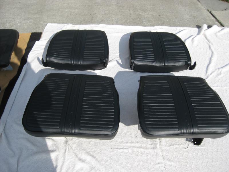

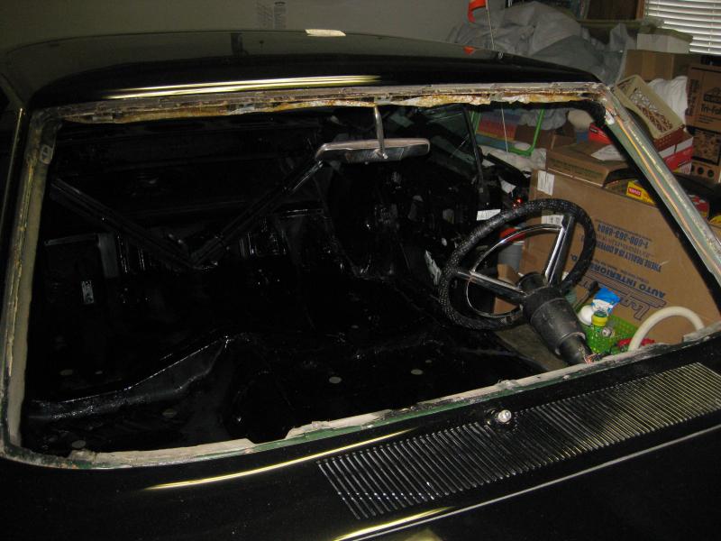

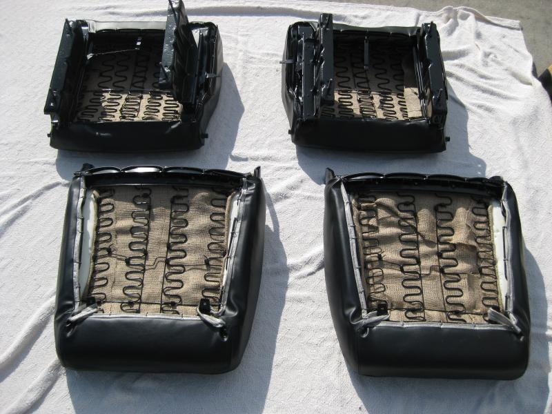

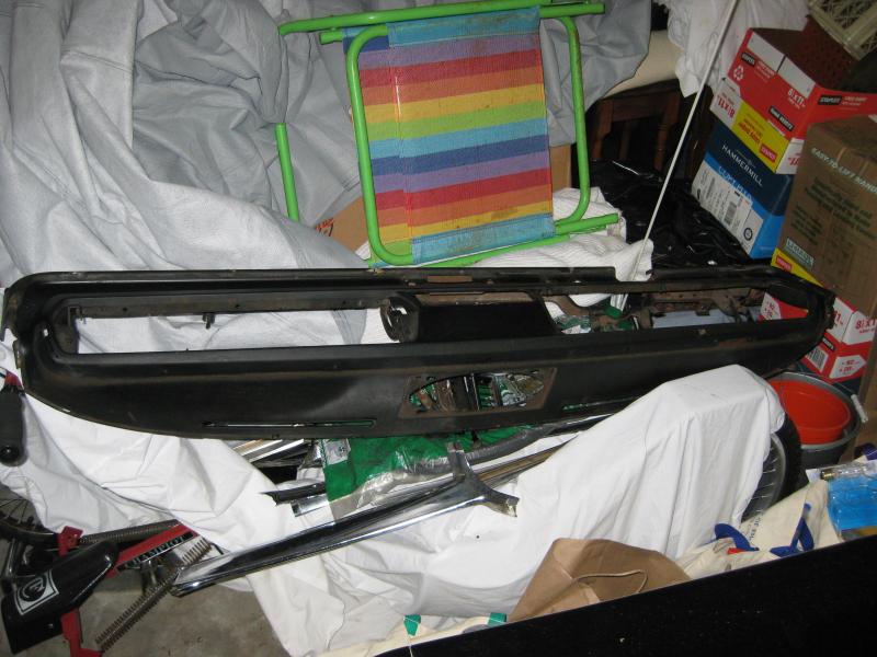

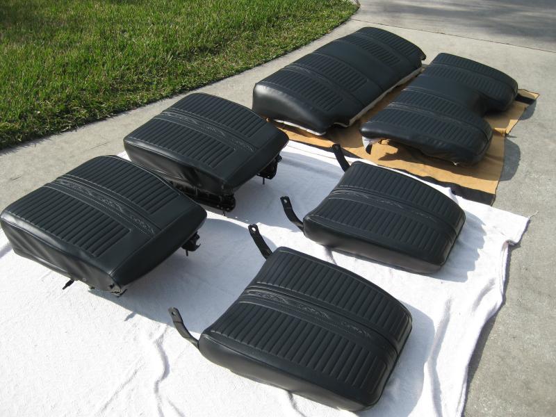

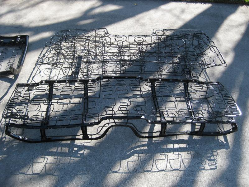

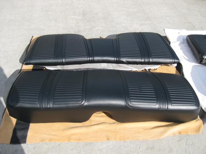

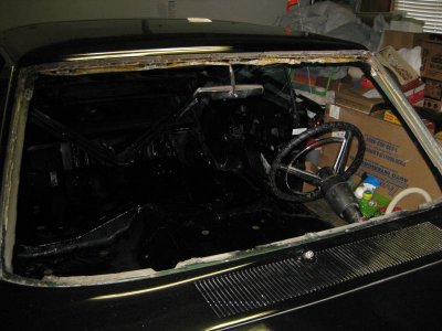

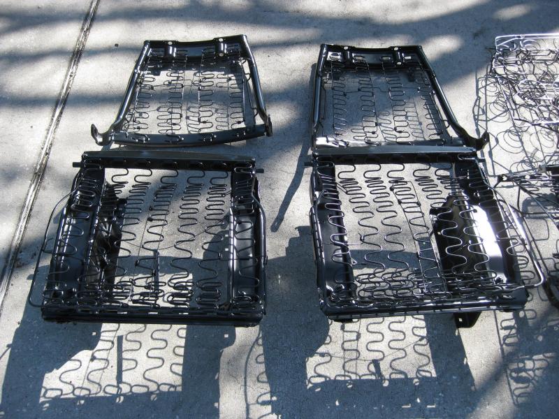

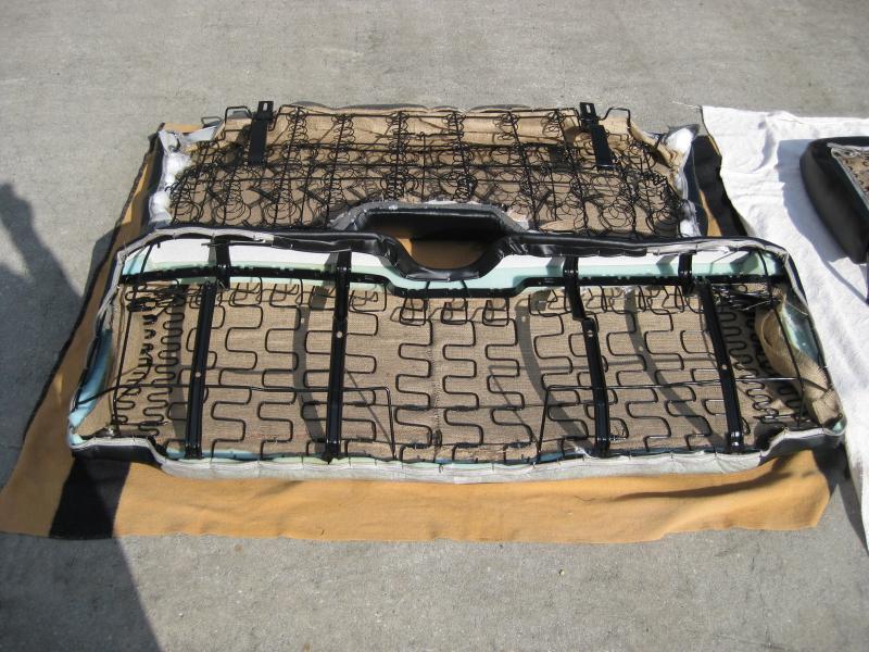

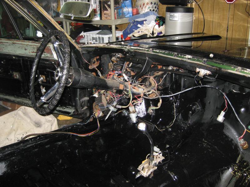

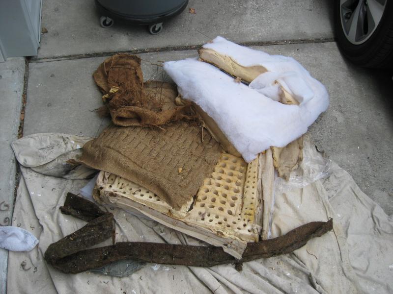

Interior done with POR-15. Seats stripped to springs and sent for media blasting and powder coating. New seat foam and new Legendary vinyl installed. Windshield removed. Dash out to paint. I am guessing dash was originally flat black around the bottom and top and gloss black in the middle above the lower chrome trim and below the dash pad to match the glove box door. Am I correct on this? Striped lawn chair next to the dash has been my driver's seat for moving in and out of the garage while seats were gone. Leaves a lot to be desired. I never would have thought about doing a complete wiring harness, but the prospect does not seem all that complex compared to when I began and began unwiring everything. I will try to replace just the slightly melted bulkhead connector first. Car still runs and drives. Just need to wear safety glasses due to lack of windshield and grab that dangling ignition switch carefully and insert and turn key. LOL

Looking good...seat foam from legendary too?
I bought the bucket seat foams from Legendary. The upholsterer did the burlap and additional stuffing as needed and made the rear foams. I told him I wanted the seats pretty firm. He did a lot of work on the driver seat springs that were pretty saggy. I sure am going to miss that lawn chair!
