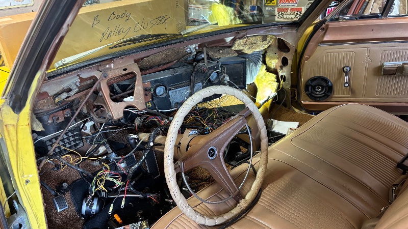

Thanks all that replied, I'm going to try the cluster route 1st, then go from there.
Here's why I need in there
