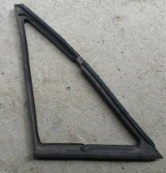

Where can I get the vent window run weatherstripping that goes into the back side frame of the vent window? Or can anyone tell me the correct size.
I also need the glass channel seals that goes into the run. Classic industries is out of stock on this part till the end of Feb.
Thanks
Try MrMoparts in Arizona. By the way what size wheel and tires are on your car and backspacing. Looks really great.

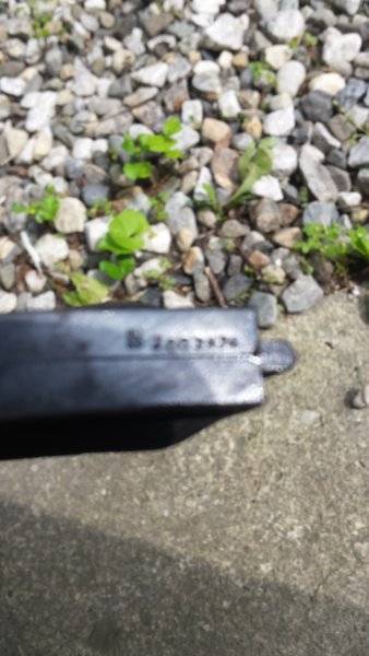

Here is one that I have, would have to look for the other side

I think he’s looking for the glass run channel that the door glass rides up and down in.
Try Mega Parts. The ones I used are Mopar ones I found on eBay. I think Mopar still makes them, I don’t believe they were NOS.
Correct, I need the one the glass rides on approx 36" long. I'll try mega parts thanks.
The mylar glass channel runs that are attached to the front of the door glass that fits inside the stainless trim is only now available in the reproduction form. Finding NOS ones are getting very difficult and not uncommon to bring up to $300 each. Both of the reproductions and originals are fragile, but the reproductions are even more so. You will have to trim to length as they are made to fit various applications even from the factory. Other than the flocked mylar run and the the vent window seal, that takes care of the vent window assembly except for the rubber bumper that sits atop the vent window frame and they are not reproduced to my knowledge.
If you are speaking about the mylar channel that attaches to the leading edge of the door glass, I repaired my original parts. Here's a thread I posted. https://www.forbbodiesonly.com/mopa...de-restoration-attempt.207311/#post-911750414
You can get new replacements BUT they need quite a bit of modification. They are not contoured to the curvature of the window glass causing them to bind and the plastic retainer clips have to be altered - sanded down.
As you will see I re-flocked mine and they work perfectly.
I bought the reproductions from Detroit Muscle recently. They are black and curved but must be trimmed and the holes cut/p inched/drilled for the plastic guides that lock them in. They are working fine.
