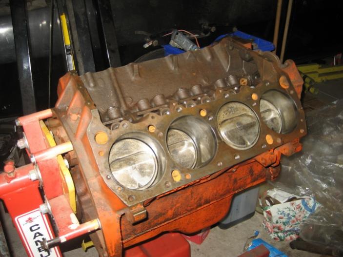

I bought a C "67" 440, bored 60 over with domed pistons, cam & hydraulic lifters & crank in it. :toothy10: My questions are ,can i install a set of 70 "906" heads & what size ,length & hollow or not, push rods would be correct? :blob1: Thanks for any help.

yes you can install the heads and just call summitracing at 800-230-3030 and talk to a rep to get the pushrods you need. you will only need a 5/16" pushrod most likely, but since your pistons are domed, I am curious to see what camshaft is in it.. make sure you talk to the rep and let him/her know your cam specs in order to get the appropriate pushrod.
now that I think about it, make sure you are running the right springs that will coincide with the characteristics of the cam you have in the engine.

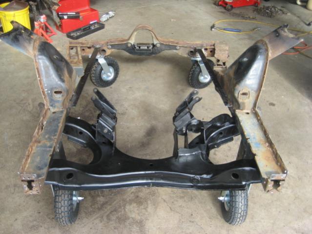

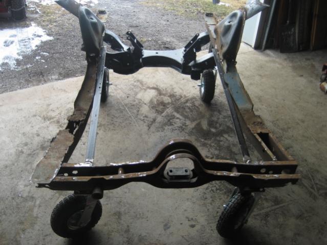

Thank You, "RACEDODGE". I`m just going to piece this together without spending big big $$, for my boys car. I`m going to run this on this stand to give them lots of practice. Thanks Again. :headbang:

By the way, those are the old TRW / Speed Pro 11:1 pistons.

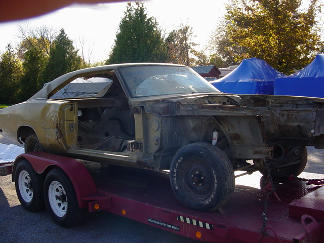

I`m going to piece together a 70 Charger out of this.

That puts you way ahead of the game compared to the other one! Nice project.
