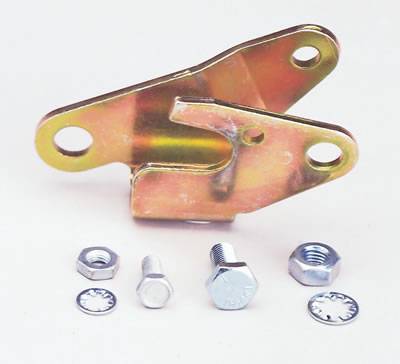

I've got manifold and carb.
Is there a list of what other parts I need?
Like kick down linkage (727 trans), throttle cables, etc...?
You might want to get one of these. Makes it easy to hook up throttle cable and kick down.
https://www.summitracing.com/parts/edl-1481/

The linkage is screwed up but engine is fine. A modified 2bbl linkage on a 4bbl setup using baling wire.
Up shifts occur at the same time no matter of gas pedal position.
No down shifts except at low speeds or stop.
Baling wire breaking at the wrong time.
Just trying to correct the problem.
