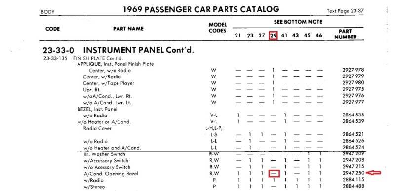

I can't say for sure from experience, but it is suspiciously missing from the "Charger" body-style (29; sports hard top) column in that B-Body row of the parts manual. I believe the Charger was automatically equipped with Rallye gauges.
The more I research and gathering information I’m starting to feel like it’s a non rallye piece which means it wasn’t thrown away while taking apart my dash lol. Thanks!
The outer trim piece is non rallye dash only. The plastic vent assembly works on both rallye and non rallye dash.

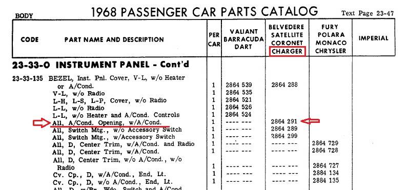

I just noticed you said your Charger is a '68 - That prior parts catalog pic I posted was from the '69 catalog ...guess I only looked at the title.
For what it's worth, apparently the "equivalent?" '68 part (2864291) fit all model/panel versions? You should verify further as needed. My Charger is a '68 w/ AC, but I've never pulled that bezel or even paid much attention to it, so again, no 1st-hand knowledge here. There's a few on Fleabay Motors searched under that part number.
