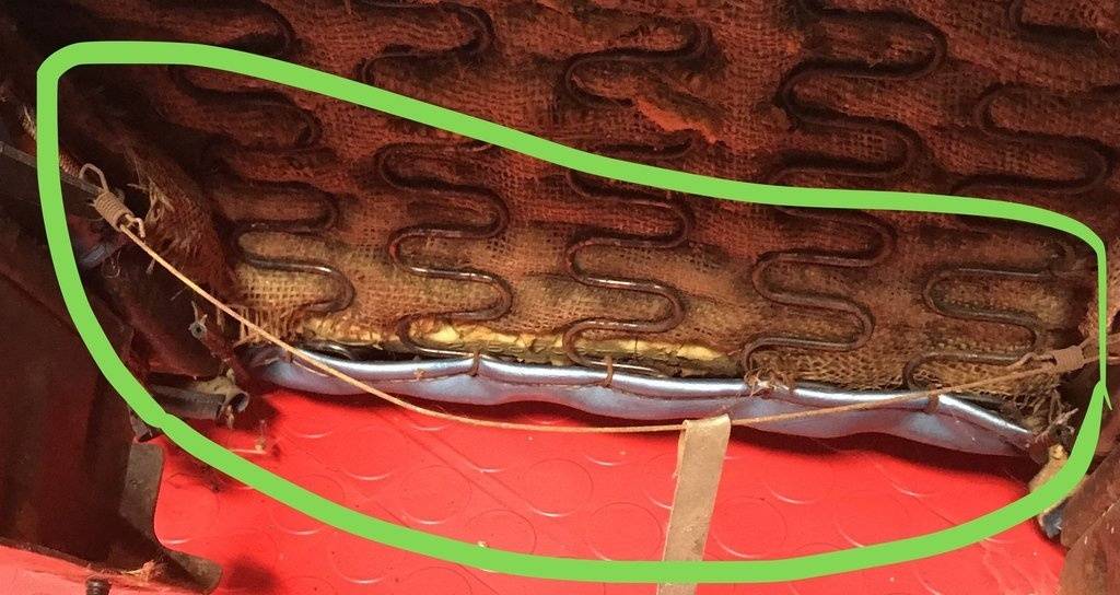

I have a question regarding the metal spring and wire that unlocks the seat track when the leaver is adjusted. Why is the passenger side an inch longer than the drivers side one? I'm redoing my seats and The guy that is redoing the seats said the passenger side wire was longer and wasn't working on the passenger side locking in the seat track. I have a set of 68 buckets in my basement and figured I would take the wire and spring out and it's the same size as my 69 seat tracks.
They are different lengths drivers is 12 7/8" and passengers is 14 3/8".
