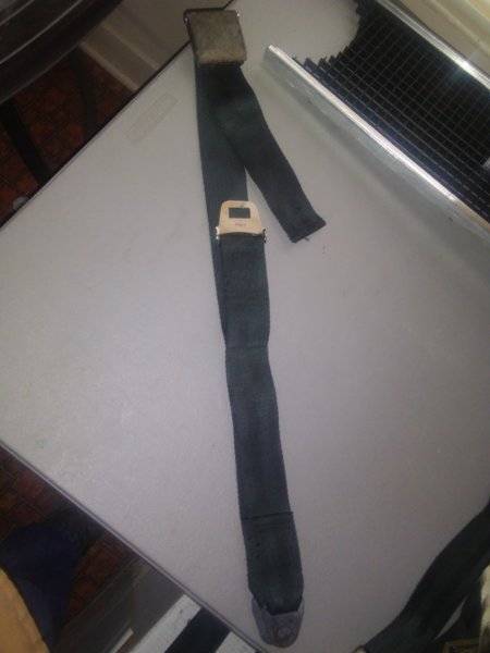

I just bought what i thought was a complete set of seat belts from a member here. This (group) was from a 69 charger. And i intended to use it in my 68 coronet. It seems i didn't inspect their ad pic close enough. As one of the belts is incorrect. From what i can tell, i am supposed to have 2 of the belts as pictured here. And i only have one. I assume these are for the front inner connection for your lap, and shoulder belt. Does anyone have one of these available ?
The belts you have pictured look like the rear seat lap belts.

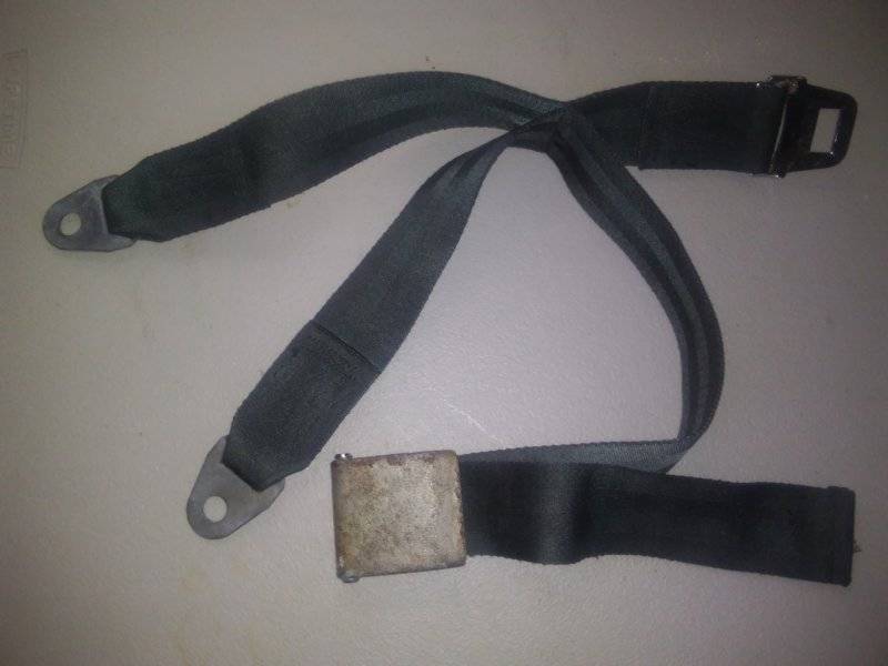

Maybe you could snap a pic of what you have laid out so we can see what you’ve got. The front lap belts have a male and female buckle sewn together the female
clicks the retractable belt and the male is where the shoulder belt clicks to.

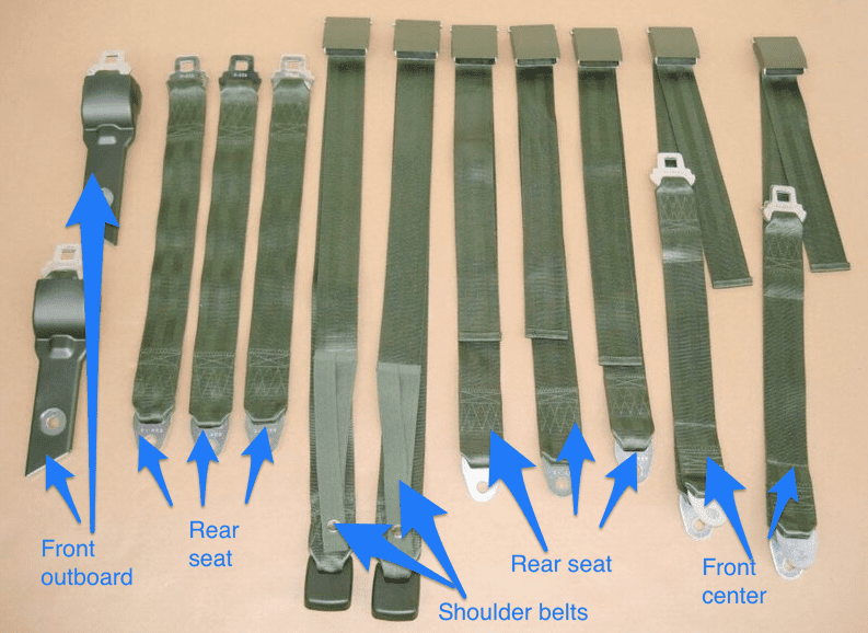

Here’s a pic for reference of the front belts with both male and female latches. Note the belts with the plastic trim cover are the shoulder belts.
Thanks, 1 wild rt. So it is one of the front center belts i am missing.
The second pic is more clear. Yes your missing one of the front center belts.
