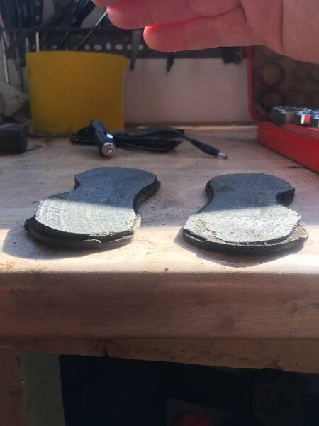

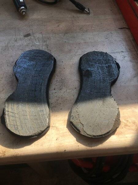

Found the front pads hadn’t been changed. (pic attached of pads).
Seems they don’t wear even. (LOL).

I can supply you with the 100 % correct 4 - piston caliper kits --- rubbers only --- $ 65.00 each (you need
Two total...) And the Front Brake pads -- yours are done... ++ N.O.S. ++ Asbestos ++ for $ 75.00/ a set...

What do you mean my pads are shot, just breaking them in :lol: Pad wise, i have some thanks,
