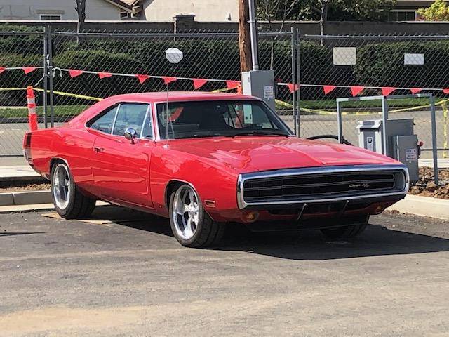

I run 1.15s in my car with an aluminum headed 440/493. The ride is firm but not harsh. It feels similar to a late model Challenger R/T.
Completely agree, I went with the 1" because the OP stated he was very concerned with the ride. I have 1.18" T bars in my Cuda (SB) and it is very stiff, I have 1" in my Challenger (BB) and it is pretty soft (not super soft), so that is what I went with as a recommendation.
