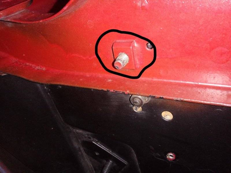

Hey Guys. I need to get a complete nut & bolt for 1 of my horns as it currently has a common nut & bolt. Any good ideas where to get them. Also what is the nut called.
But they do sell them. I just seen them for sale some where but I can't remember. I look at so many site hard to keep track. Sorry.
Rectangle that's threaded and welded onto the support. Got a chunk of steel around? Drill and tap a hole, shape the part to look like yours and tighten it in place. Nobody will know it's not welded.
Thanks Guys! Unfortunately I don't have a tap set or any steel lying around but I'm pretty resourceful so I'll figure it out.
You could probably find a cage nut that would fit in the hole. Some of the bigger hardware stores have them in their fastener bin department.
