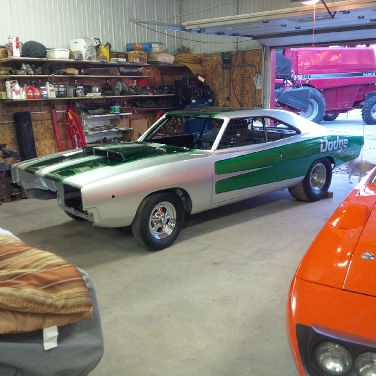

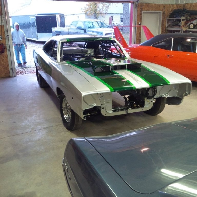

Your '68 has a F/C look to it!
Post up some pics when you get it done :thumbsup:

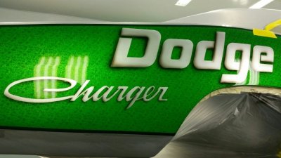

Thank you! Glad to see my idea may have worked. I based the paint on a combination of 3 of my favorite Mopars, Dick Landys Chargers, Bob Banning's Challenger Funny Car and the Imperial Kustoms Charger funny car. I'm hoping to show it in public for the first time next month at Mopars in the Park, Farmington Mn. Lots left to do, I may have to push it into the the building, but she'll be there. Here is a close up my paint with the lace
