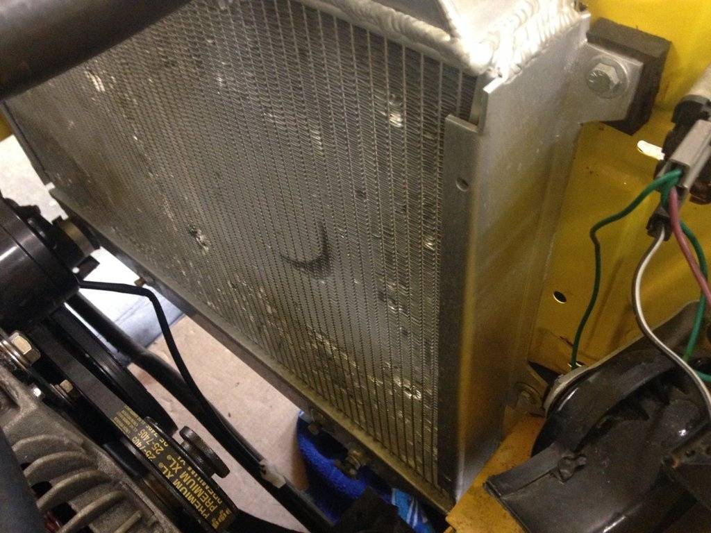

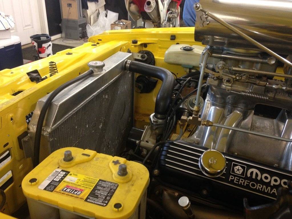

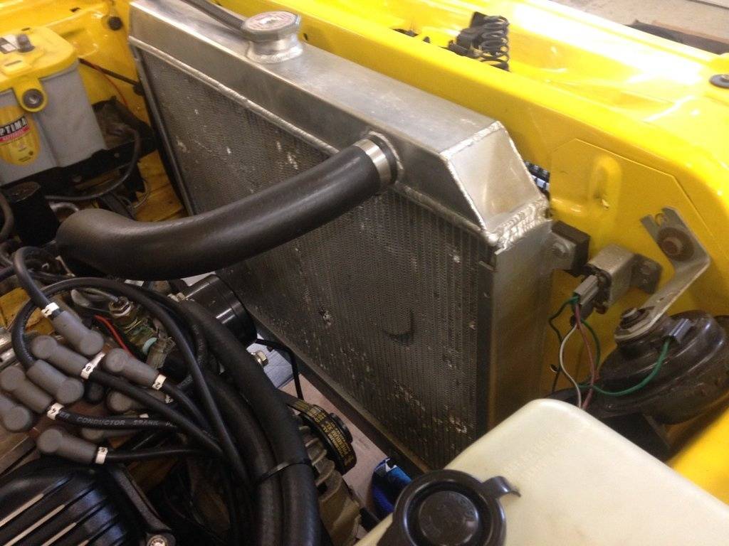

Post a pic of what ya got.
Will do tonight when I get home and can snap a pic in shop.
Leaning towards the viscous over the thermal if I do go that way though.
Looks like I have a rail to screw a shroud to! Awesome! Also the electric water pump is going too....mechanical is way more reliable.
Perfect. Now get ya shroud, about 140 from Summit and your set.
