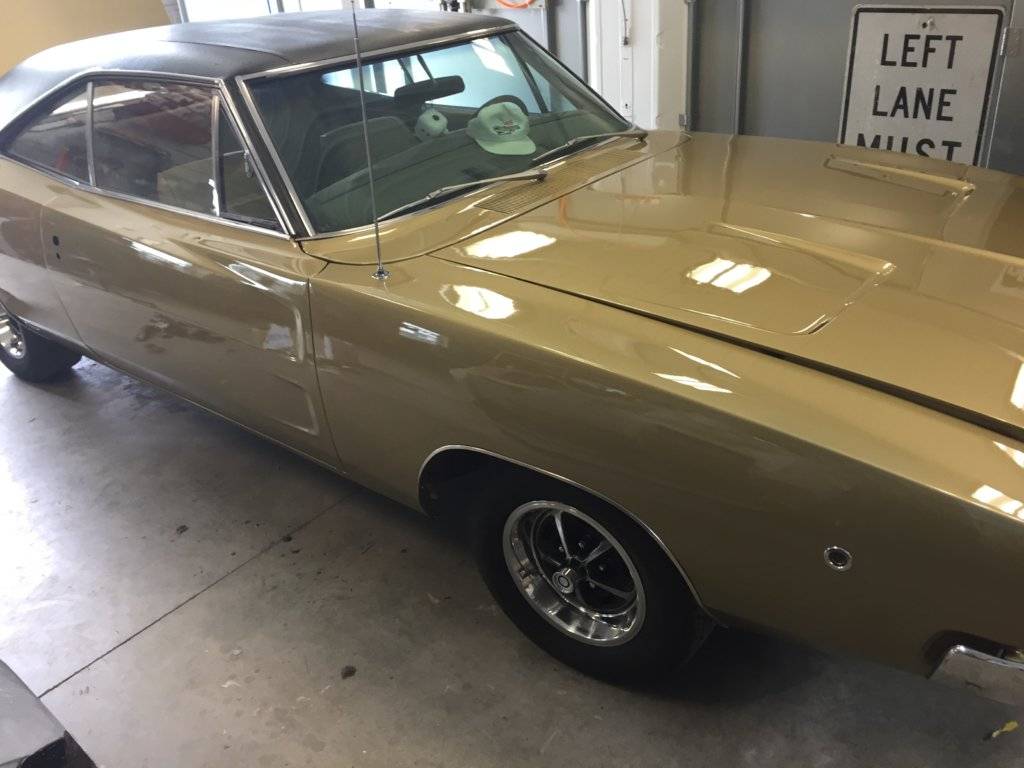

I have a 68 non Rt 383 HP. Just painted her. Year One has the vinyl cutout decals for the hood turnsignals. they have flat black or a glossier black. Does anyone know for sure the black that is correct? Also, need to paint the back taillight pan. I know it's not gloss, but it's not flat I believe. Any knowledgable help is appreciated. Thanks

Nice looking 68, how about some more pictures?
