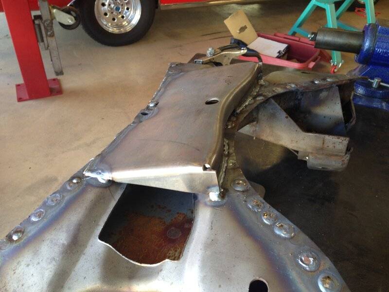

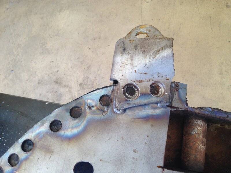

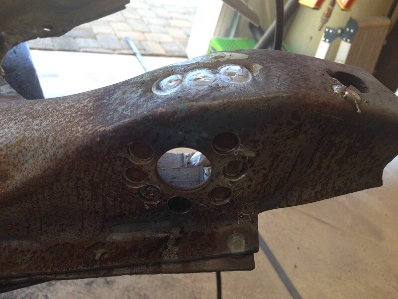

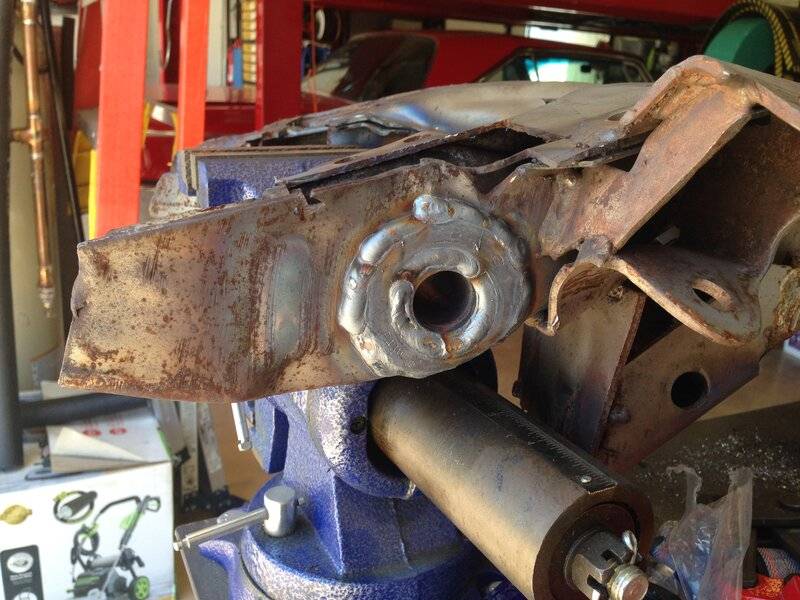

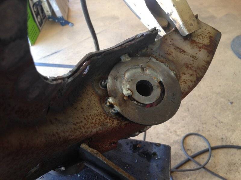

If you have a welder, some scrap metal and some hole saws[ I used Blair Rota Broaches] you can do quite a bit of improvements on your stock k-frame. Just takes some time. I added in 120+ welds to mine, over the factory 30 or so, plus added reinforcements around the lower control arm tube and the strut rod mount. Good time to add a skid plate but thats not free unless you do your own. The big washers I used around the control arm mount were sourced from Fastenal.
View attachment 1072295 View attachment 1072296 View attachment 1072297 View attachment 1072298 View attachment 1072299 View attachment 1072300
Definitely a worthwhile low cost upgrade.... Just a little time & effort... Firm Feel offers a gusset package if you want a shortcut...
