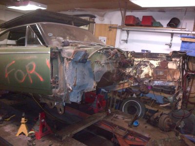

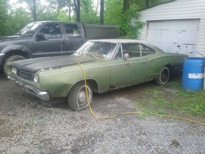

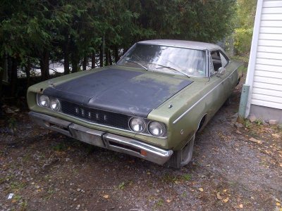

I bought this car back in September, it was a complete running slant six, 3 speed car that was last plated in Missouri 1986. The car came with new quarters, trunkfloor, not installed, as well as a good used right rear frame rail which it definately needed

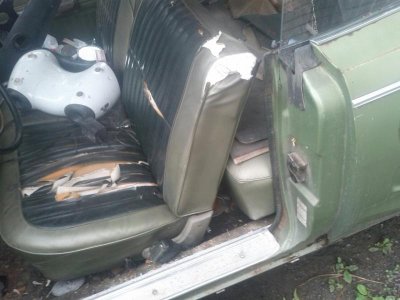

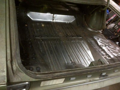

Trunk floor was non-existant and the right rear rail was punky
out with the old and in with the new!

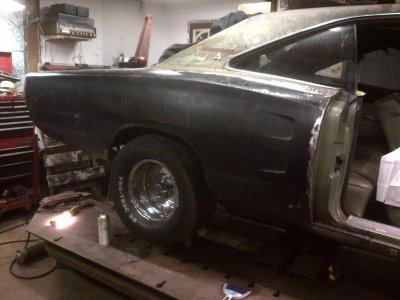

And one of the quarter panel

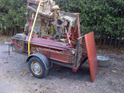

Both front rails were worse than I thought once I started poking at them. I found a 70 Coronet parts car with decent front rails, I also stripped off anything else I thought I could use or sell/trade for other parts

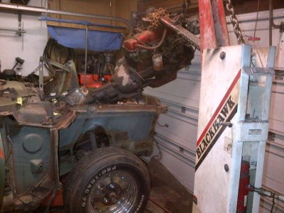

My plans call for a 5.9 Magnum so the Slant6 has gotta go, thankfully I found a new home for it locally as it was a very good running motor

I started this back in October, I'm just going through my pics and will soon be catching up to where I am at now. I haven't actually done all this work in one week:toothy12:, right now I have the motor/trans in for mock up and working on the wiring harness, I'm hoping to test fire sometime this week

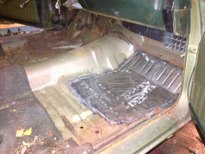

Floor pans

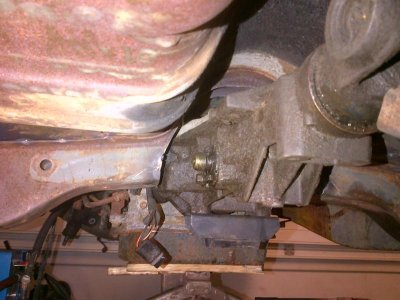

fitting the A518, didn't have to modify the floor but I did have to take a bit out of the floor brace. I will box it again once I am done

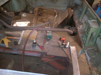

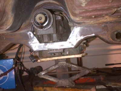

Fabbing the new crossmember, still have to drill out two more holes
