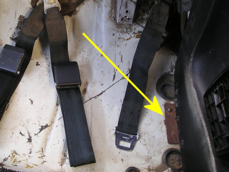

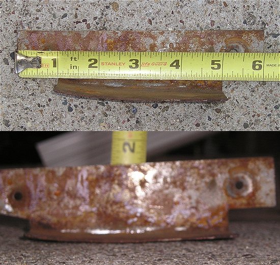

I'd like to know if anyone is familiar with the installation of the rear interior panels on a '68 coronet convertible. This car is FINALLY being put back together as a restomod. This car was a '500' that has been sitting apart for @ 26 years and was converted to an R/T but never completed. The interior is being done now. I think that there are angle brackets that these panels mount to ? May have gotten tossed during disassembly in 1988. Could anyone send any info or pics as to how these attach ? Thanks.
These are from a 69 R/T convertible. I presume the 68 is similar. They attach the lower part of the rear panel. I have more pictures if you want to see them.

Thanks so much ! That really helps a lot, particularly the measurements if I have to make them myself. I see that the larger 6 inch side of the bracket screws to the back of the panel and these screws will be covered by the carpet on the panel
