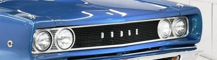

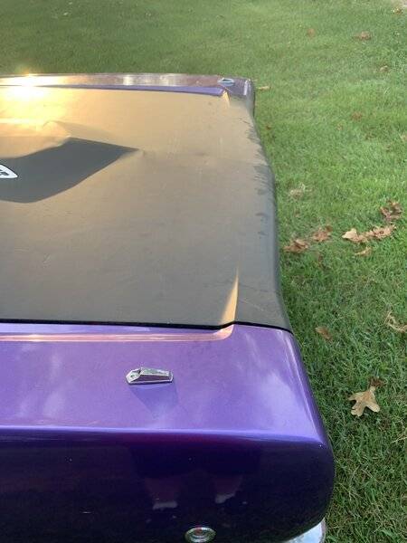

Just happened to be staring at the car the right way this afternoon, and had an "oh $hit" moment. My passenger fender is from the car originally, driver fender I bought at a show a few years ago. The side lights are round and identical location, the headlight buckets are offset on both fenders. The fenders are virtually identical except the location of the turn signal light!
What the actual hell? Maybe someone added them after the fact on the driver fender in what looks like the 69 location?
Passenger (original)
Driver (bought)

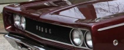

Thanks for doing that!

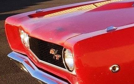

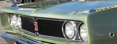

I did similar but was really looking for images that matched my original fender since I was sure someone had put the driver side holes in later. So what you've found seems to say they can be in either position?
Unfortunately, I haven't got a clue. I mean, it appears so, but who knows what's original and what's added on the cars in these pics. Finding some factory sales literature with images, or better yet, some blueprint, might guide...but without that, I think you have to pick one to match and weld the other up?

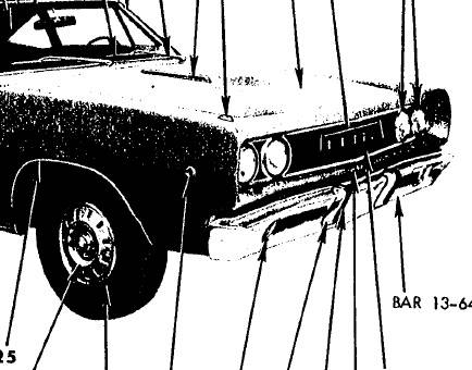

I went through the FSM this AM, and couldn't find an illustration with them. I did find this sales brochure on ebay that shows them in the forward position. And agreed, regardless I have to weld 'em up and move them forward. Although they might be easier to see further back. I'll have to toss a coin on that one.
Thanks for your help!

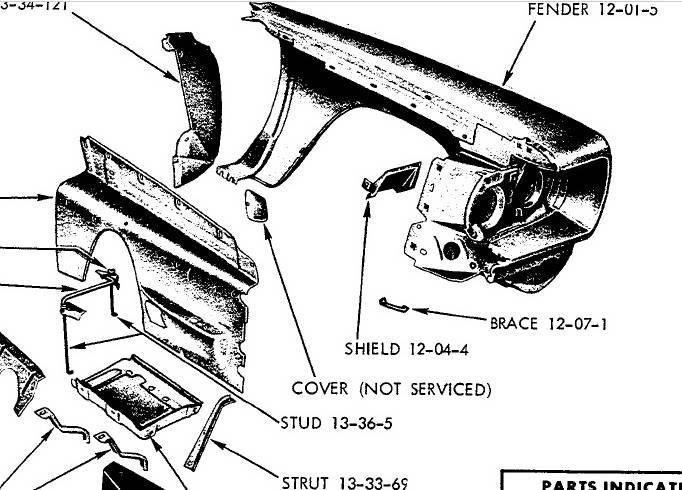

Yeah - parts manual is no particular help either: Only one part number listed and illustration doesn't show the turn signal. Good luck.

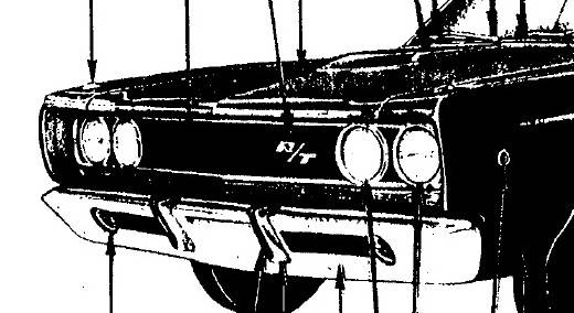

I looked at my Mitchell for my '69 Satellite and in that case, it wasn't helpful at all - one part number and reference to labor time to "drill for signal". Occurred to me to look at the pages in the parts manual with the signals - even these looks like two are forward, but one "appears" rearward? You'll have to judge for yourself...sorry.
