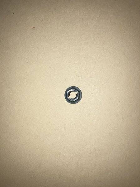

Pull the radio and you should be able to get at it. There are four nuts that hold the speaker in. The studs those nuts go on are attached to the dash, So that is what allows you to take the nuts off and then replace them. It is not easy, but compared to pulling the whole dash, which means pulling the windshield, it is less work. In situations like that I try to use my small battery powered impact using as many extensions and knuckles as needed to get at the nuts and zip them out.
These type of nuts are used (only with a smaller hole). When putting the nuts back on, I have had good luck taking a small piece of tape and taping the nut to the socket to keep it from falling out of the socket. I am sure someone else on the forum will know what size the nuts are. I am not positive, but because of the length of the studs, I think you have to use a deep well socket. Quarter inch drive is the best to use Because of the smaller size and weight.
There are only 2 3/8" nuts holding up the speaker to the dash frame, one on each end. Like stated above, its pretty easy to get out once the radio is pulled.
These type of nuts are used (only with a smaller hole). When putting the nuts back on, I have had good luck taking a small piece of tape and taping the nut to the socket to keep it from falling out of the socket. I am sure someone else on the forum will know what size the nuts are. I am not positive, but because of the length of the studs, I think you have to use a deep well socket. Quarter inch drive is the best to use Because of the smaller size and weight.View attachment 1112402

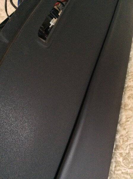

These people repaired my dash pad for $75. Looks like new but was some time ago. Not sure how bad your's is but you may want to give them a call. Also, consider shipping costs today as prices have skyrocketed and they are on the other side of the country. https://www.drvinyl.com/dr-vinyl-of-new-york-state/
looks great. did you also paint the metal part that is closer to the windshield?
The dash was restored and painted in MOPAR suede paint which I understand is no longer available and was $125 a quart from Instrument Specialties. There are many posts here about painting the dash and/or powder coating it. Lots of good ideas from some very smart people.
