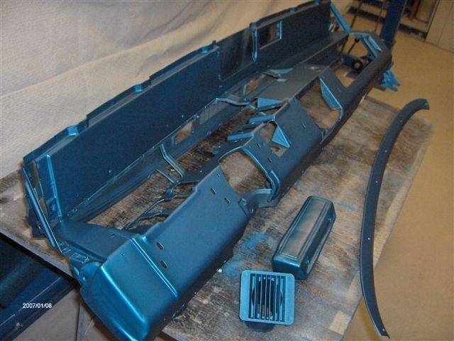

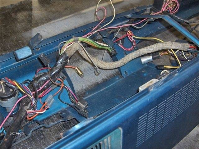

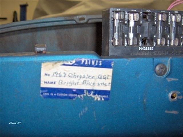

I restored a 68 Hemi GTX about 12 years ago. This is the dash as it came out, including the factory paint code label. Maybe what you're looking for.
Just as it came out of the car
Sprayed.
