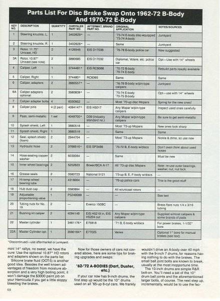

Parts list.

I bought 1970 gtx set up spindels then got everything else new for 68 coronet that was org disc couldnt get any org parts havent started yet hope to hell I was right.
