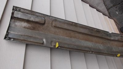

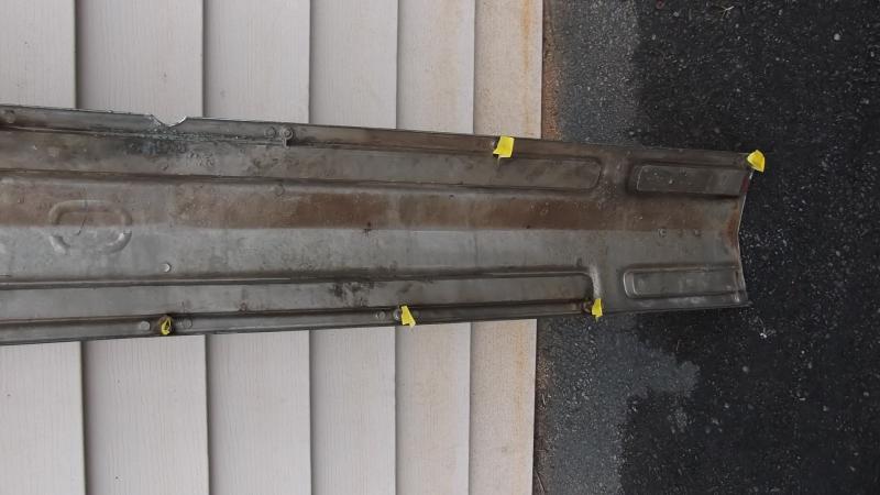

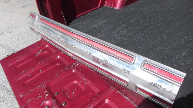

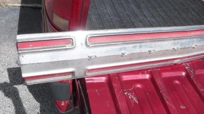

this trim panel would be decent but it's missing 6 of the 12 studs.i'm not sure how you would fix that.otherwise it's in pretty good shape with little pitting and one small dent.looking for either a 68 69 or 70 column.floorshift preferred but i'm always looking for parts also.pm me if interested.thanks,kent.

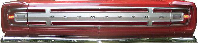

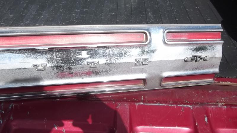

Sorry for hi-jacking the post, but the pics show what I am asking about. How do you re-produce the rough finish that is on the tail-panel. That finish is also on 68 Roadrunner grilles and part of the 69 headlight trim. Thanks for any help......................MO

That process is indeed very difficult to reproduce.
I can recommend a man in TX (who goes by the name "Mister" on here but isn't on FBBO much) who did mine to factory perfection. His name is Bob:
Yes, that's mine he uses in his ad. Dude is a perfectionist.
In regards to broken studs on these, that's a common malady. If you're CAREFUL, you can drill and tap the holes, then use all-thread rod to screw in new ones, epoxying them in place.

2. It's not correct for the '68 GTX tail panels anyways - the original finish on these is a darker shade and is surprisingly rough to the touch.
Bob @ oldcarpartsdaddy has one of the few remaining stashes of the stuff in the country. Give him a call, he's quite approachable to chat with even if you're not buying something.

Hell, look at mine. Doesn't get any better than that and definitely NOT the argent Chrysler used on other parts.
