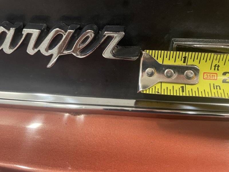

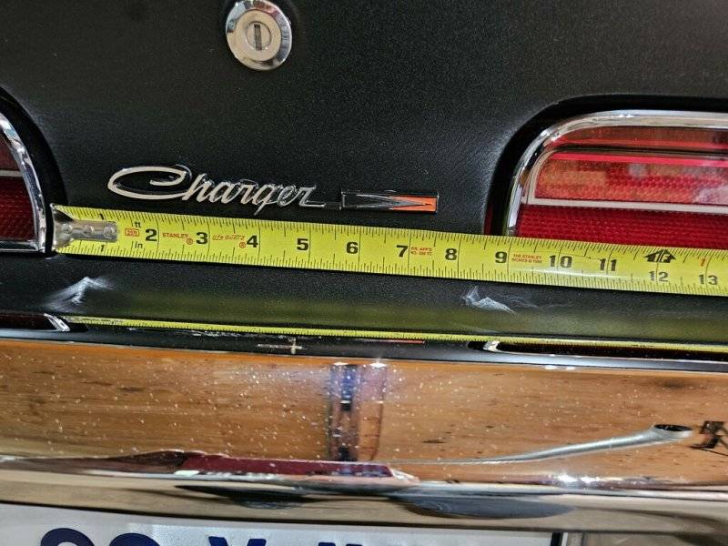

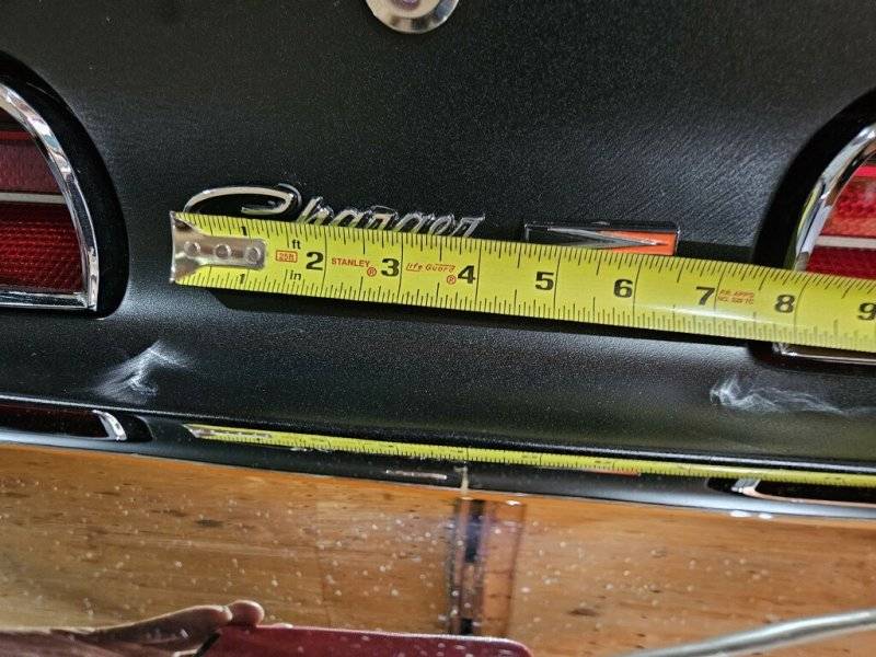

Hey Folks,
Does anyone have some good measurements for where the tail panel emblems are placed for a 68 non RT tail panel
This would be the Charger "script" and the "arrow" emblem.
I can find quite a few post for the R/T cars but not plain Chargers. Wondering if the script emblem goes in the same place as an R/T?
Car is being painted soon and would like to get these holes drilled.
Pictures would be good too and maybe I could figure it out from there.
Thanks !

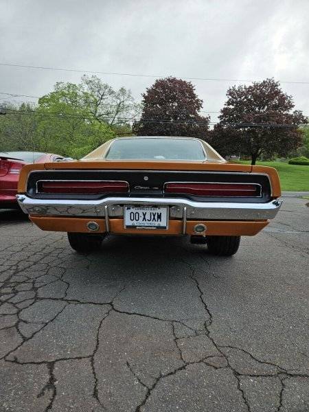

From our ‘69 NON R/T, hope they help :thumbsup:
Thanks so much guys ! Yes the 69's are different but appreciate taking the time to post. Those 68 pics are just what I need !
