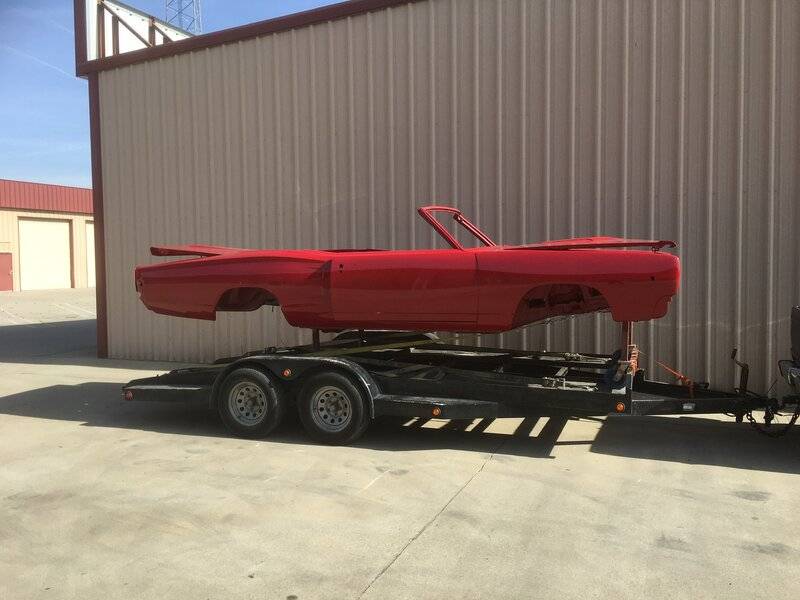

Just putting the final touches to my rotisserie R/T convertible resto, fitting the rocker panels. The bracket fixing holes have "disappeared". Can anyone help me with a template or measurements & centres for the holes? Have scoured the internet with no luck. Guess I could put the brackets anywhere but am **** on getting everything as perfect as possible. Appreciate any help, Regards, Ron J (New Zealand)

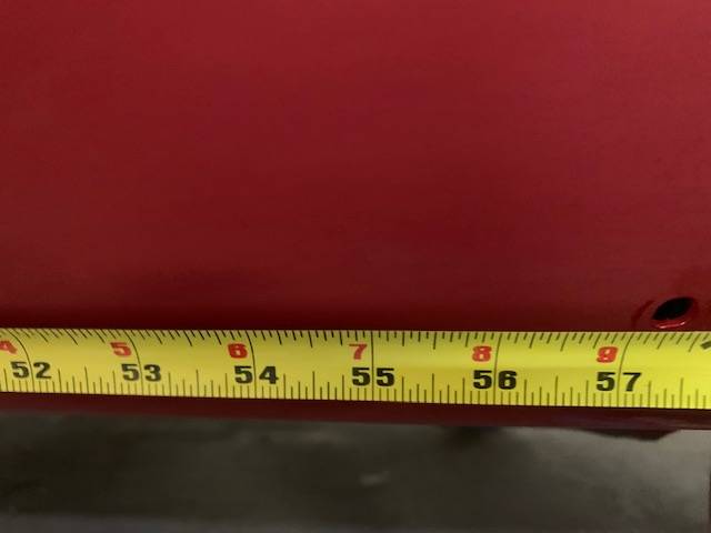

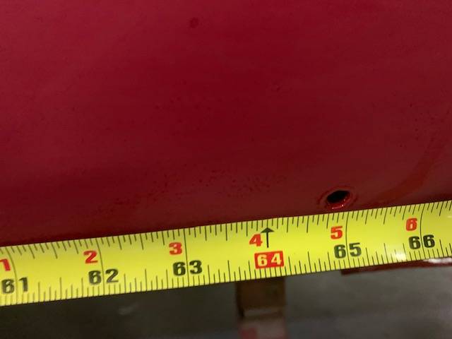

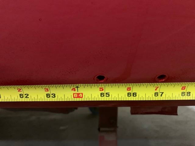

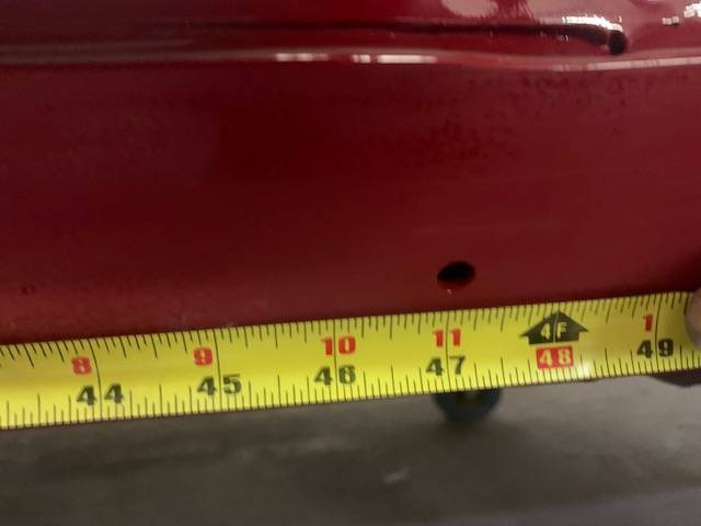

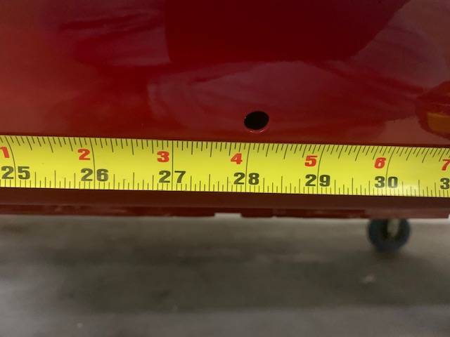

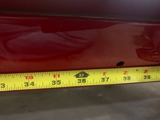

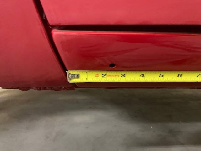

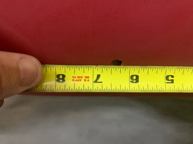

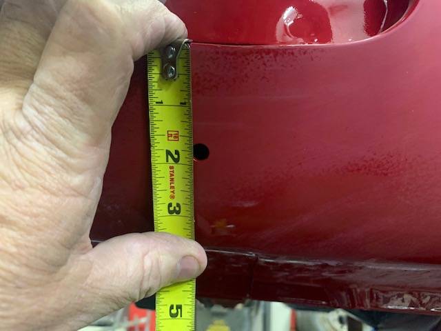

Okay hope this helps... All front to back measuring was done from the rocker/fender gap so the one going forward on the fender was taken upside down...
This is the front fender
I measured in three vertical locations from the door jamb down to the holes and they were all the same..
