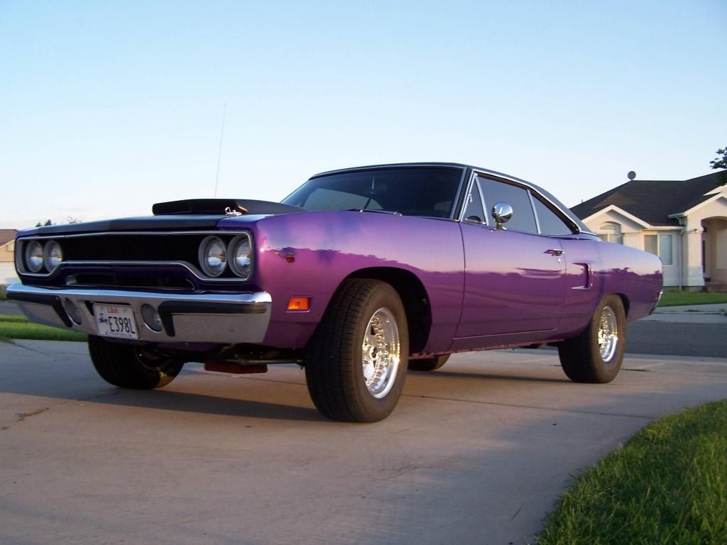

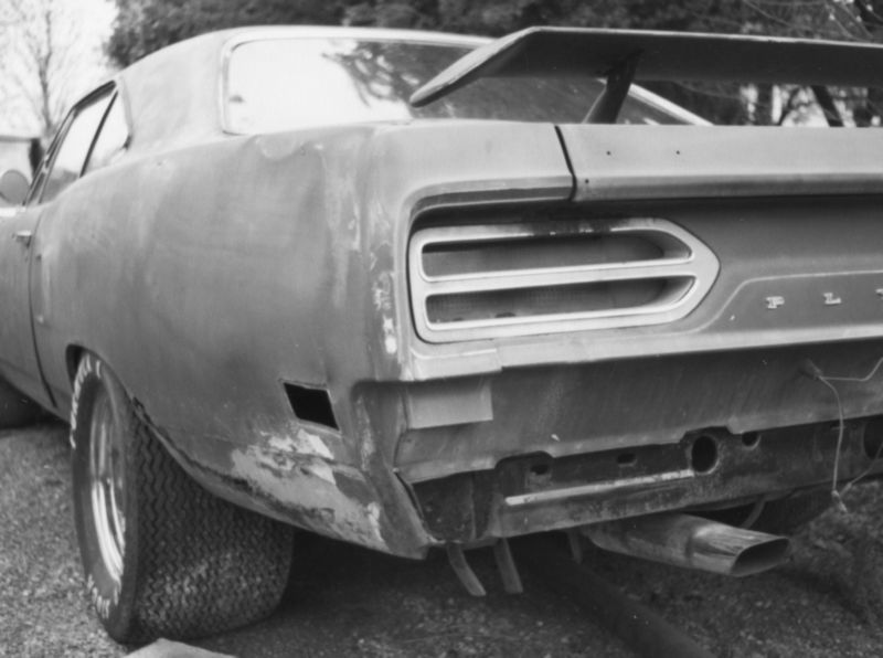

I'd say...no. I did have N-50-15 (Formula One Super Stock) tires on my '70 for awhile in the 80's, and that was with air shocks pushing the back up a bit. They scraped if the shocks were let down, putting scratches in the raised white lettering. And the inside was really close, actually polished the paint on the frame rails. I had 15 X 10 Appliance mags for those.
Just for kicks, I tried putting those same tires back on my car last summer. With the new quarters having a slightly wider wheel well flange and no air shocks, there was no way they'd fit.
Here's an old picture of the rust bucket thirty years ago :)

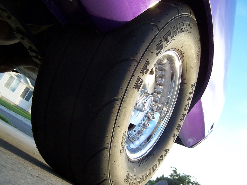

Hi, I'm a newbie here but still want to say welcome! Photon440's old pic showing the tires is awesome! Those bring back good memories! Not sure if it will help but I looked and looked for the largest tire that would fit mine, ended up with MT DOT 295/65/15 DOT slicks mounted on 15X8's with 4.5" backspace. They end up at about 30" tall and 11" tread width. Need to run superstock springs though.
