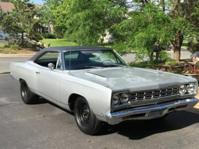

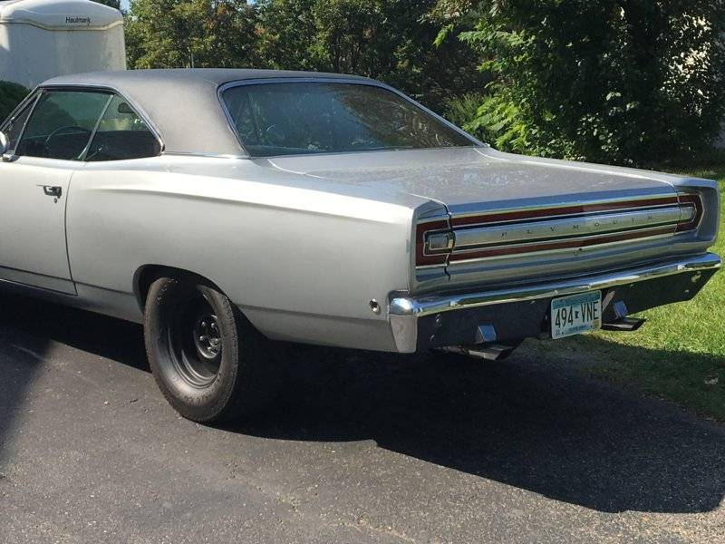

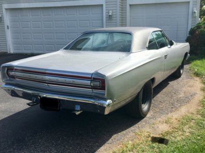

I run Wheel Vintiques OE black steel wheels 15x8 with 4.5 backspace, Coker Bias ply N50s. 8 3/4 rear and drum brakes.

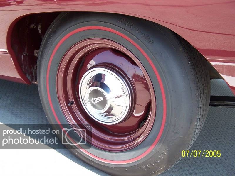

Did some research quick for you.....they are full of **** when they say they won't fit the poverty caps unless they are completely clueless. They offer the cap pictured below which is a center poverty cap for their 63 series wheel. This is the same setup that all the other poverty caps use to mount to the center of the wheel. SO someone there either is clueless or they are advertising false info. See below.....it says right in the wheel add that they accept the center caps for the poverty look. All those mopar center caps of that era are the same size in most cases. They all fit the center fingers on the inside of the wheel. Maybe post a pic of the caps you are trying to use? Are they Mopar caps?

Yea most all of those caps are the same I.D..... I'd be willing to bet he either used your number of 8 5/8" approximately while its actually 8.75", or he doesn't know what hes talking about. If you have these below, and those other caps fit, then yours will as well.

The guy clearly has no clue...he’ll it even says in the add for the wheels it fits the 8.75” center caps! Glad to help!
