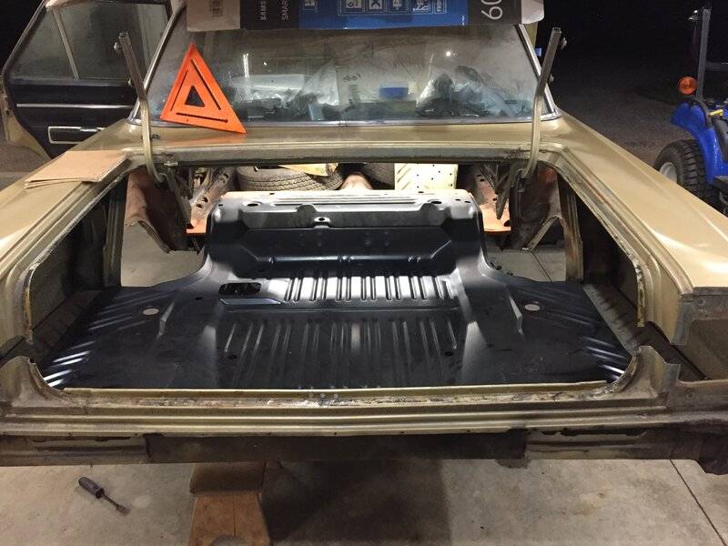

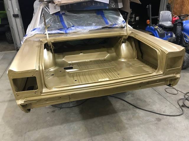

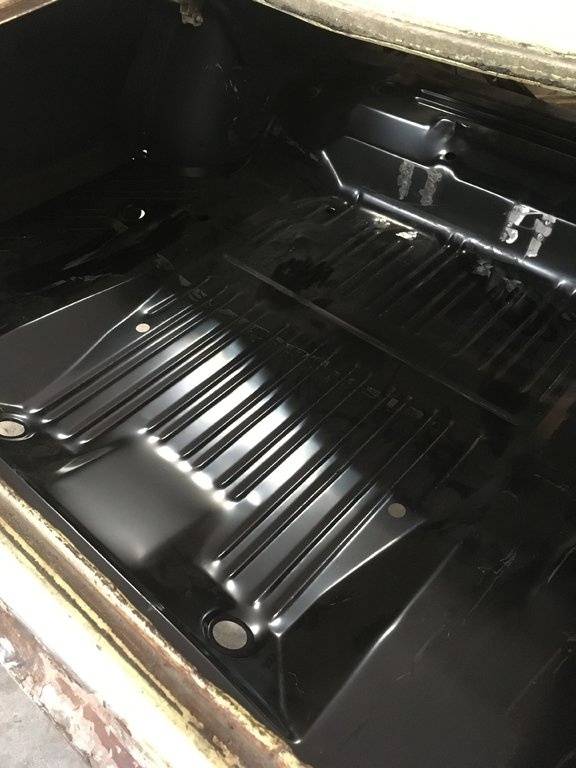

I'm posting slot of pics, to get it up to date. These are the new trunk pan, extensions, rear support brace, and hangers. I had a little repair as well to the frame rail and tail panel. I know everyone knows this but AMD stuff is amazing! And if the rear support is removed the 1 piece floor will slide in there, pics are proof lol!
View attachment 510939 View attachment 510940 View attachment 510941 View attachment 510942 View attachment 510943 View attachment 510944

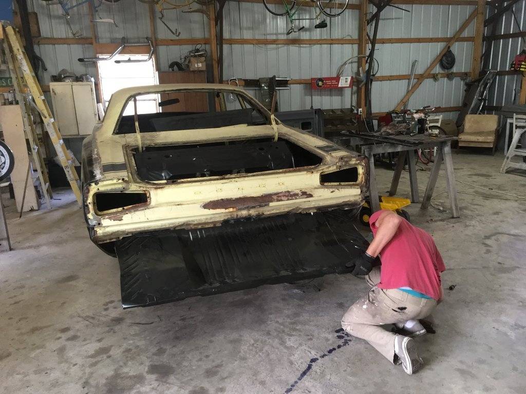

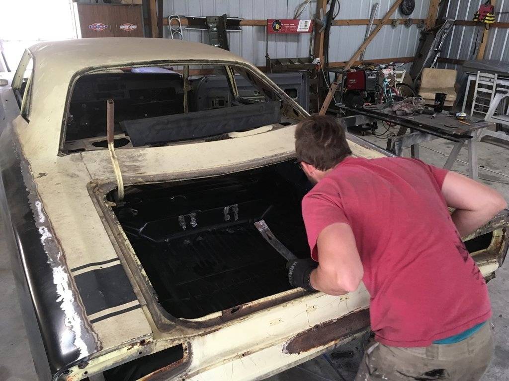

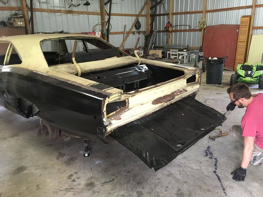

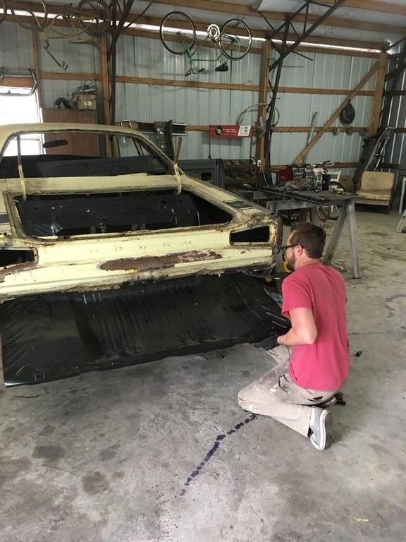

If you have a 68-69 Plymouth you can slice a thin section out between the tail light and the trunk seal and slide the floor pan in. I put a 69 charger floor pan into a 67 belvedere this way and the welding is very minimal and mostly hidden when all done. To keep the rear tail lights properly supported, I used a piece of 1"x1/8" flat stock and welded studs in that fit into the tail light extension housing bolt holes. I fit them up prior to the cut to make sure nothing was "sprung". I only removed them to install the pan....but they were in there the entire time the slice was open otherwise. Here are pictures of during and after.
View attachment 1002342 View attachment 1002344

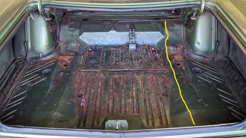

I was thinking that I could cut the new 1-Piece floor pan along the frame flange; see my very crude photo with my proposed cut line. Based on my measurements, it looks like it would go in, then I could weld back together over the frame easily. The seam would not be visible from below.
I am sure this is not a new idea, and would love to hear back if it will work.
That's how I do mine. Works great.
As you noted, you don't have to dress the weld from below and as an added bonus, there are no blowouts as you're directly over the flange.

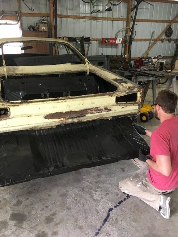

The one piece trunk floor will slide right in from behind if you partially or fully remove the tail panel. This is simple on a Super Bee, since the old trunk floor has to be seperated from the tail panel anyway, and only the sides are left to seperate. By the way, I created the post on Moparts with the blue Road Runner that you mentioned above. I have done many this way. Here is the link again.
