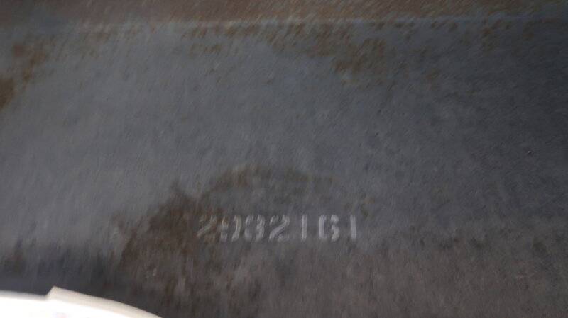

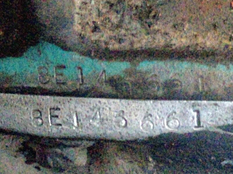

Do you have a picture of the Vin plate?
BAFRAID....here you go, Ironbuilt... its kinda of a win win if we sell the house I get back the kitchen money, if I sell the Bee (not happening) I get the money back.
WM21H8E146661 SPD 3/15/68 LA, and I have the Build sheet along with most of the original paper work, including the first temporary registration that is taped to the windshield. I know this cars history from date of purchase to today.

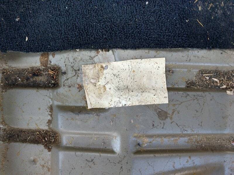

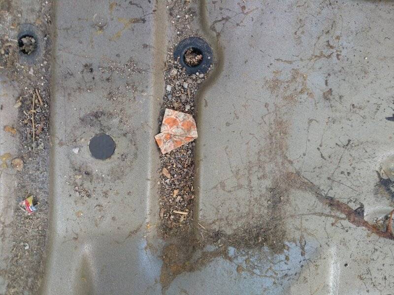

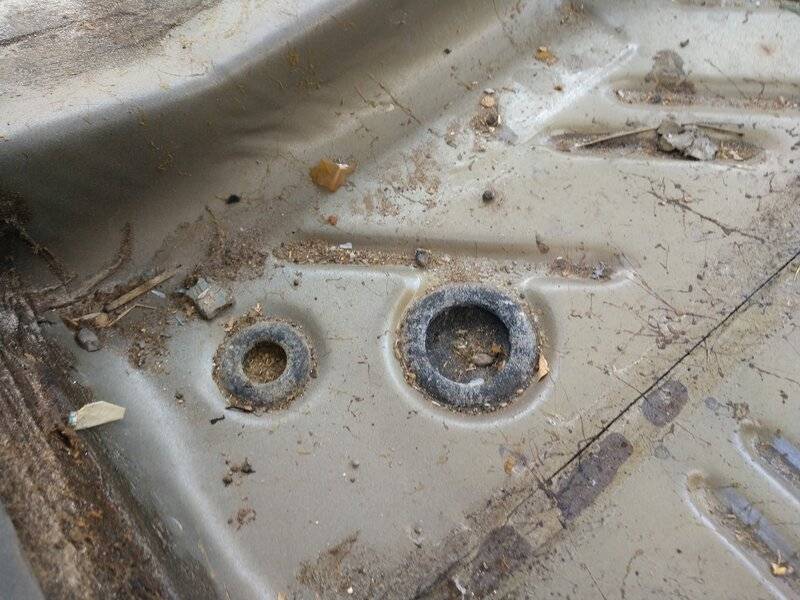

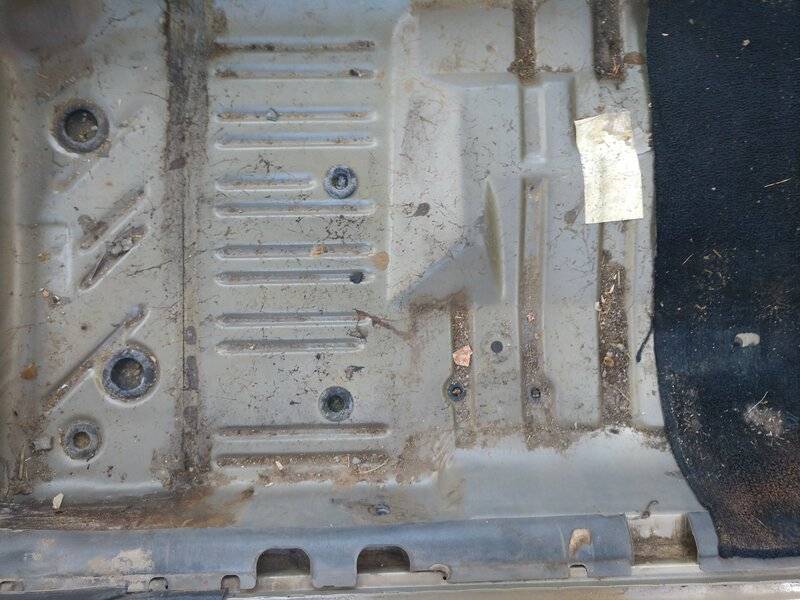

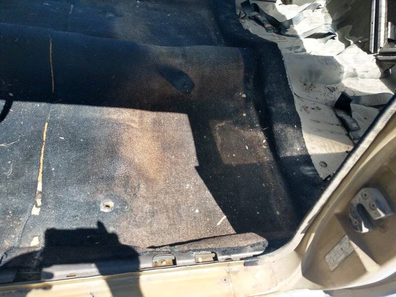

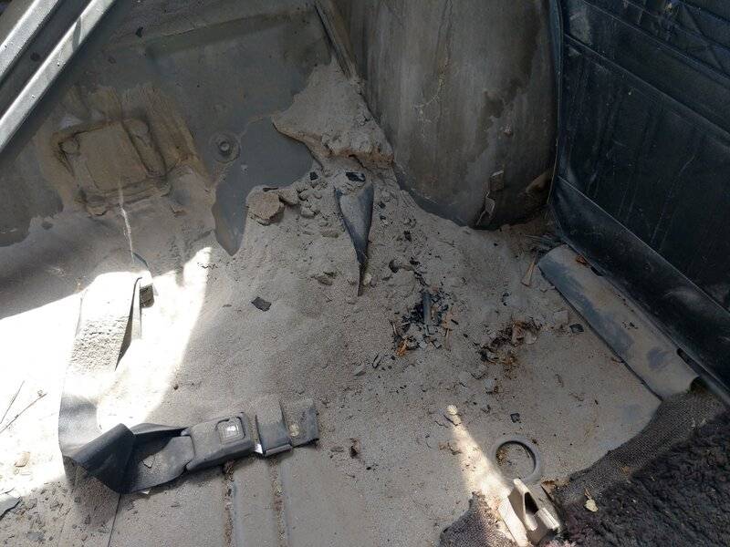

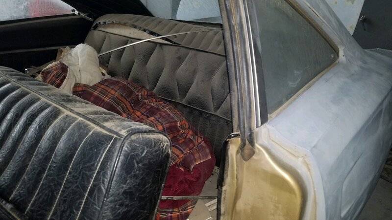

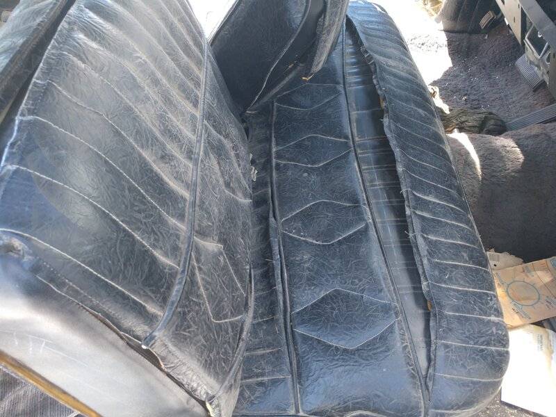

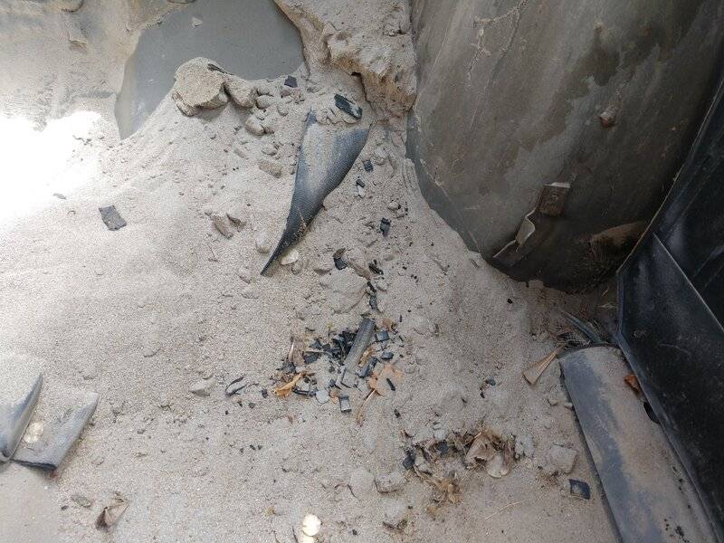

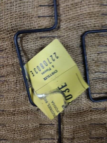

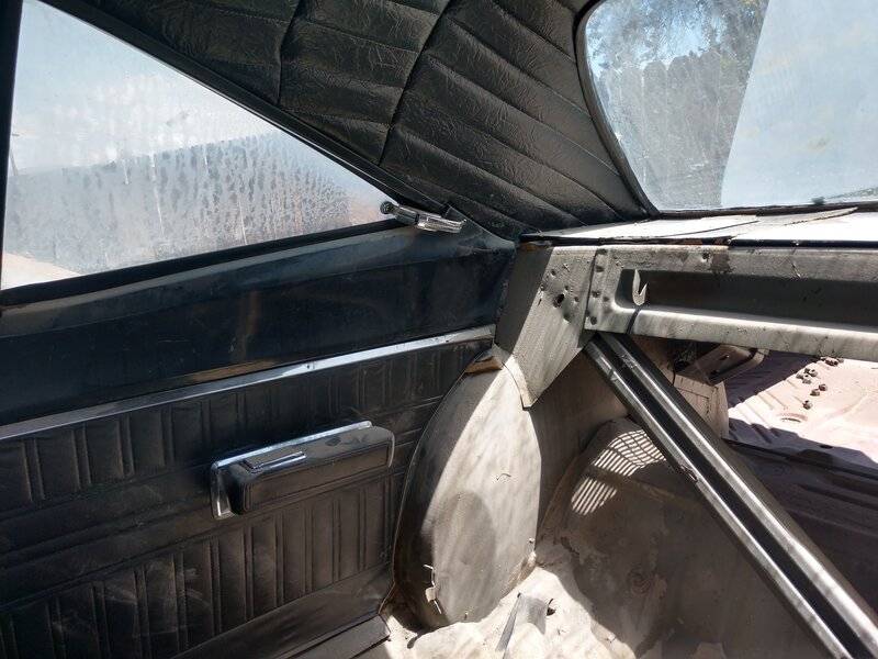

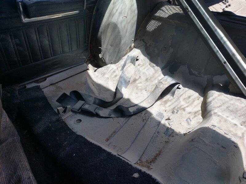

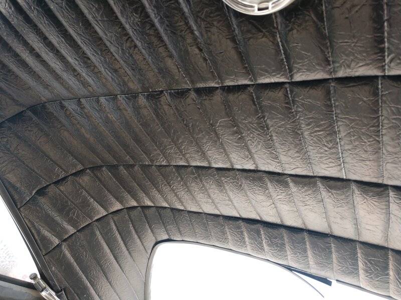

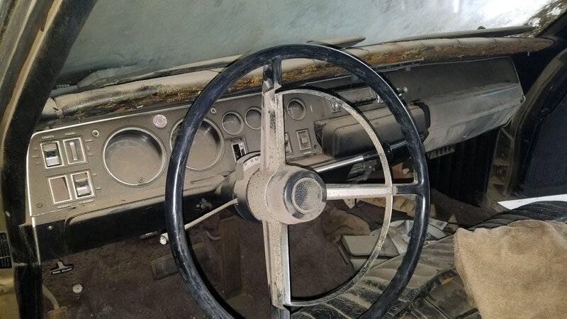

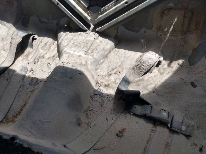

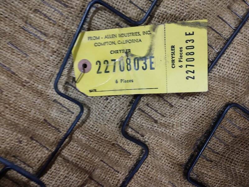

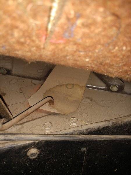

The car eventually passed from J to his daughter (whom I purchased it from). The interior had become quite fried, the desert is unforgiving to plastic and vinyl. So he drove the car to Tijuana, there it received the tuck and roll treatment. Very common at that time to take a car down and for under $100 new upholstery would be installed over the existing. When I got it to my shop the seats and carpet were removed. Most of the original seat covers and the original carpet were still in place under the covers. After removing the seats I removed about 3 gallons of super fine dust. (more later). This dust was everywhere, body seams, frame rails, window regulators , HVAC components.
12321.jpeg IMG_20190525_135420330_HDR.jpg IMG_20190525_135424291.jpg IMG_20190525_135428372.jpg IMG_20190525_135431093_HDR.jpg IMG_20190525_135433684_HDR.jpg IMG_20190525_135437087_HDR.jpg

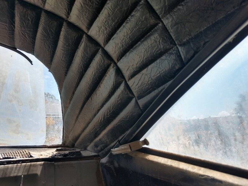

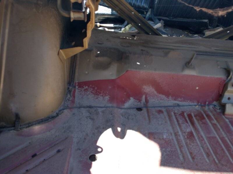

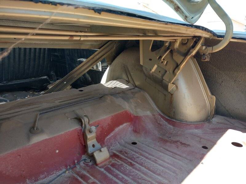

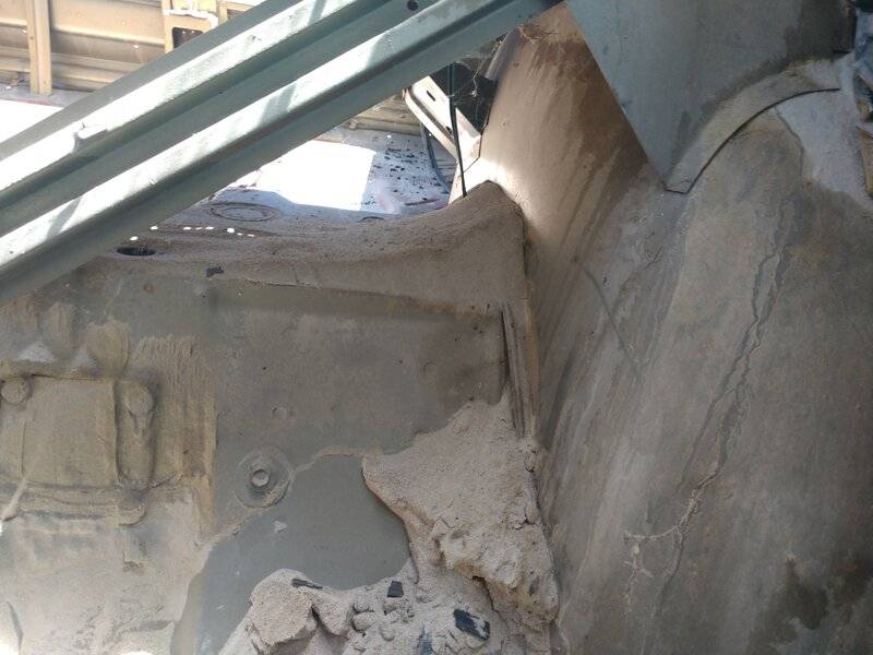

At some point someone was smart enough to protect the trunk floor with a brush on paint/sealer. Check out the patterns on the headliner and front seat, rear seat had same pattern, the tuck and roll were on the dash pad and kick panels. The dust was every where.
IMG_20190525_135441591_HDR.jpg IMG_20190525_135445747.jpg IMG_20190525_135519452_HDR.jpg IMG_20190525_135523039_HDR.jpg IMG_20190525_135902244.jpg IMG_20190525_143314407_HDR.jpg

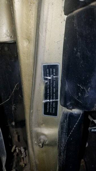

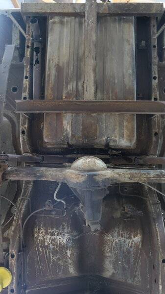

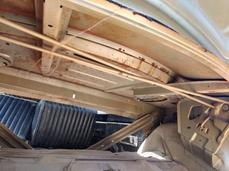

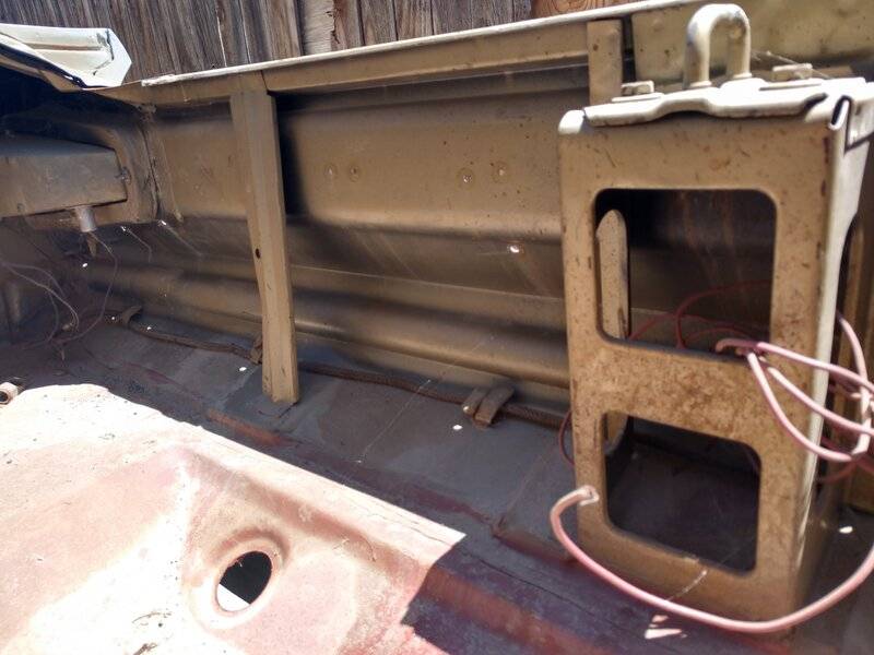

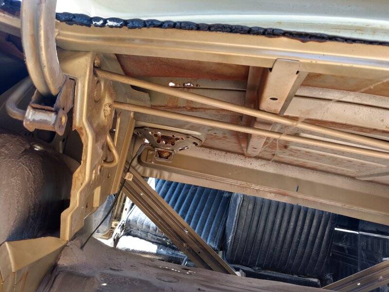

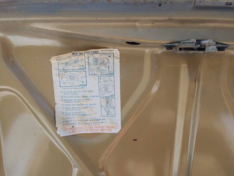

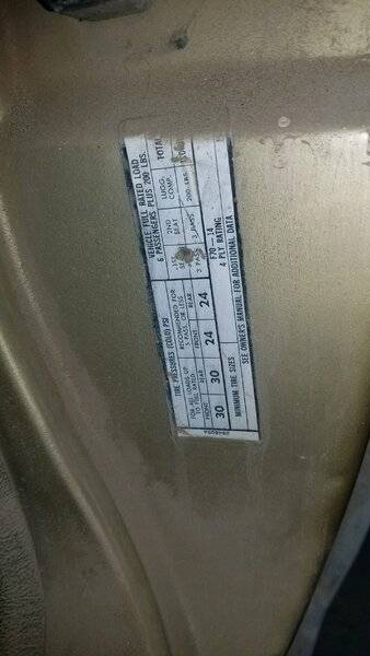

This Bee is rust free with the exception of a couple of pin holes on the lower rear window gutter, if you look close on the shots looking up from the trunk floor you can see them, pretty lucky here in the desert rust is not an issue. Original jack instructions.

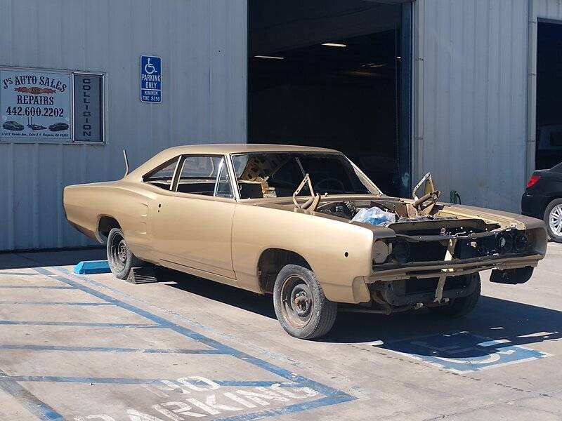

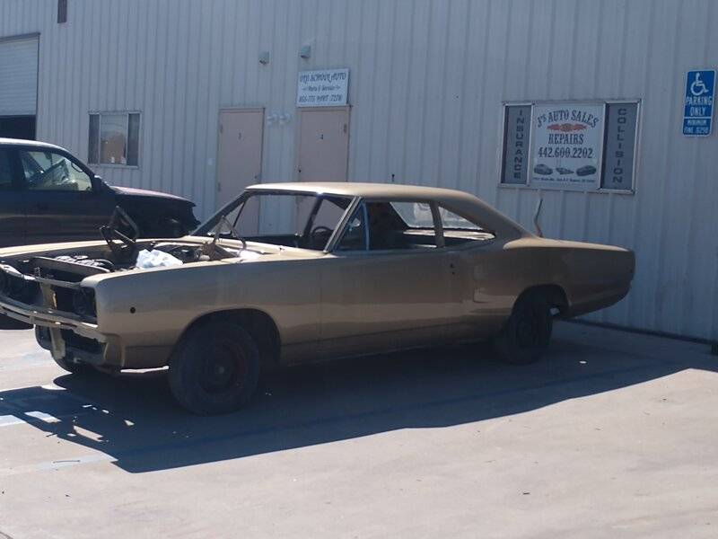

The Bee got an entire repaint in JJ1, The stripes were removed ("they were stupid"). The daughter drove it for a bit but decided she wanted a bug. The Bee became a weekend driver to tow the boat, until a freeze plug began to leak the car was retired to the back porch. It sat for many years, then one of the young men in the family wanted to do something with it, the grey spray bombing (there is a debate with in the family which one of the young men had the interest). J passed away and the cars were being sold off. My brother in-law text me picture and asked if I was interested, Mothers Day weekend, and our wedding anniversary. After some negotiations with Wifey we went and looked at the car. Apparently the daughters husband had contacted some of the TV "professionals" and was told they car was not interesting enough. Lucky for me, a deal was struck, and the refurb was about to begin. The windshield, interior, pop outs, all exterior trim were removed and car went to the painters. The idea was leave jambs, engine bay, truck compartment alone. Strip exterior to metal and build up to the finished JJ1.

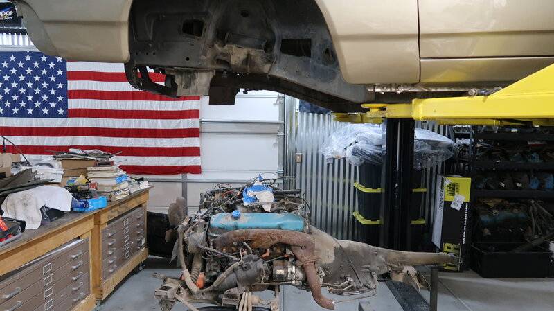

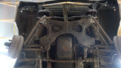

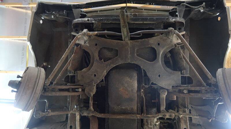

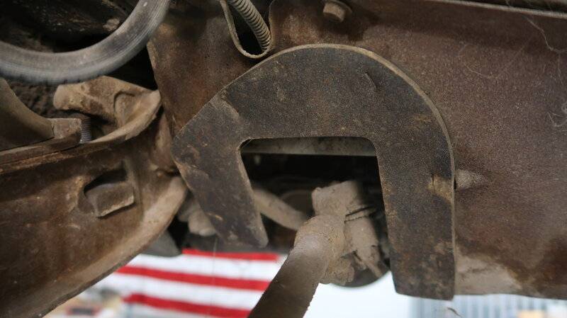

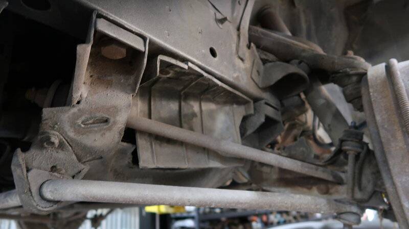

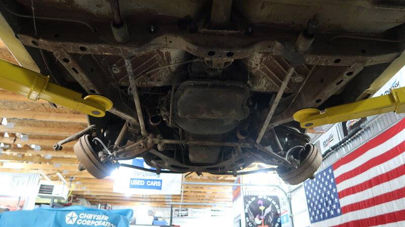

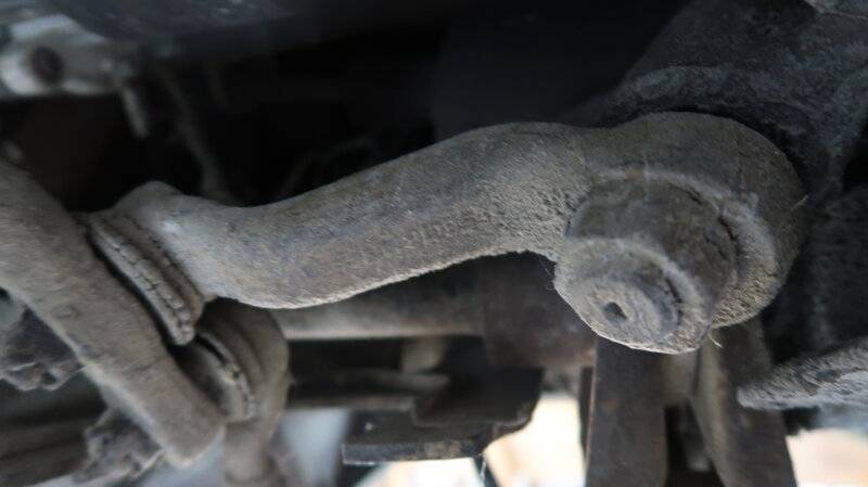

After the 3 month sentence turned into a 9 month stay at paint shop jail, it went to my uncles shop where he applied the vinyl top and head liner (Legendary). The car came back to my shop where the refurb began. This car was kinda added in to the schedule as I was working on some other projects that had been purchased years ago. I began with documentation of existing parts. The car still had the original shocks, as well as the original suspension and drive line components. The lower ball joints were shot, so they were removed as well as the rubber parts. Mopar performance replacement dust boots were used, and MOOG ball joints and bushings were also used.

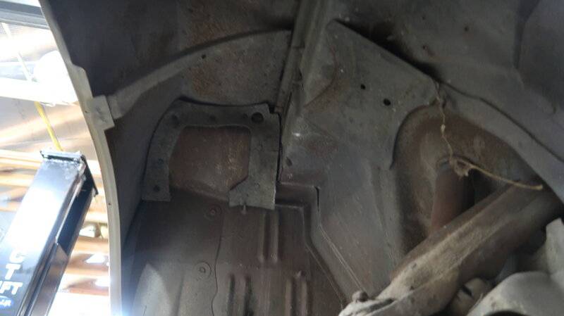

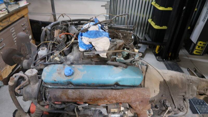

The car was stripped of the rest of the suspension, running gear, plumbing, wiring. This car is meant for driving, not a trailer queen like a couple of my others. After removing everything I softly wire wheeled the entire under carriage, then rust mort, then distilled water, blown dried, scotch bright as needed, Metal prepped, the brushed on Eastwood semi gloss chassis paint, two coats about 10 days apart. This car has no undercoating, except in the rear wheel wells. There is none in the front wheel wells? Running gear out.
