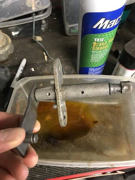

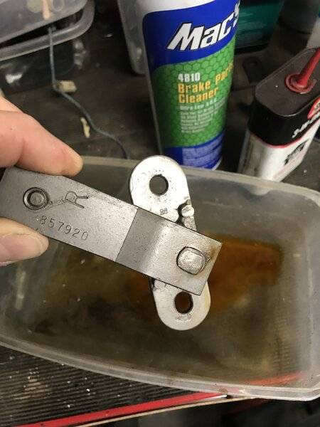

Reaching out again after a few months to see if anyone has a spare wiper arm pivot mechanism for a 69B body specifically a coronet. It’s the right side part number 2857920. Mine is completely locked up and it has been soaking for at least three months and still no movement I even tapped a couple holes in the side of the case to let the oil penetrate.
Have to heat it near red hot with torch....then work it back n forth with vise grips.....that is how I freed mine up years ago
