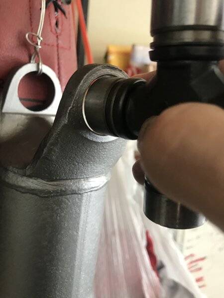

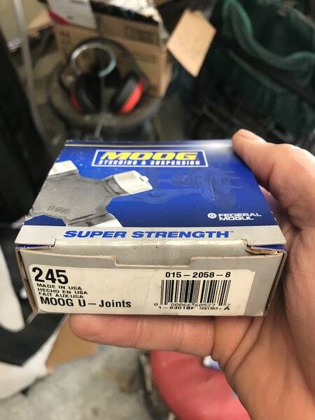

So I ordered a set of U joints for my 69 Super Bee. Put the information in online, products came up, I ordered them through parts geek, they got here and they don’t fit. Can someone please provide me with the correct information for U joints that fit?
If you order parts online, and they don't differentiate between 7260 & 7290 when looking up the U-joints, you are more than likely to get the wrong one. I assume the pis shows the cap smaller than the ear hole, so I would have to say you got a 7260 (small) joint, and the shaft ear is for a 7290 (large) joint. I looked up the 245 joint, and all it will say is the car it fits, which is obviously too vague.
The sizes are as follows:
7260: Caps 1.078" dia and 2.125: between ears (inside) on the driveshaft
7290: Caps 1.125" dia and 2.625" between ears (inside) on the driveshaft
