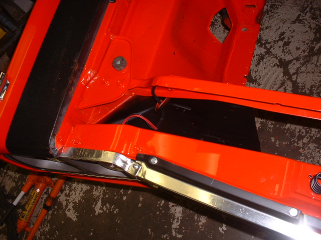

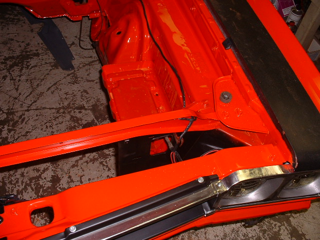

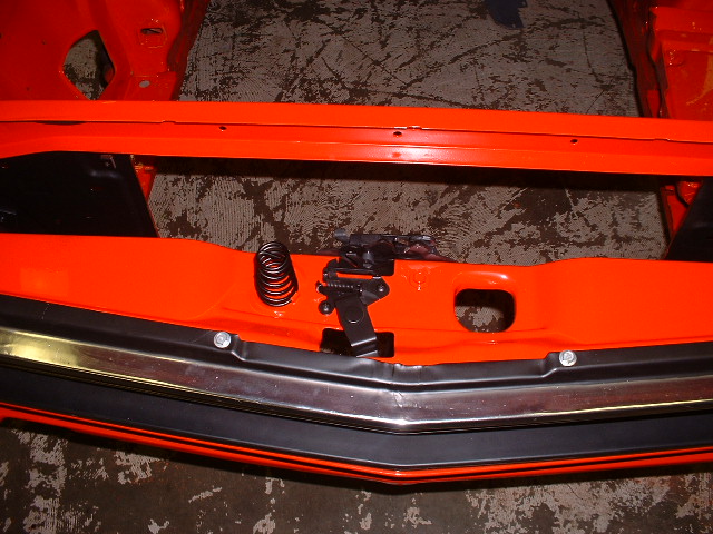

Here is how I did my 69 RR. Not the best pics for that detail but you get the idea. Also the latch tray vertical brace was blacked out.
DSC00511 (Large).jpgGrille installed 1.JPGGrille installed 2.JPGGrille installed 3.JPG

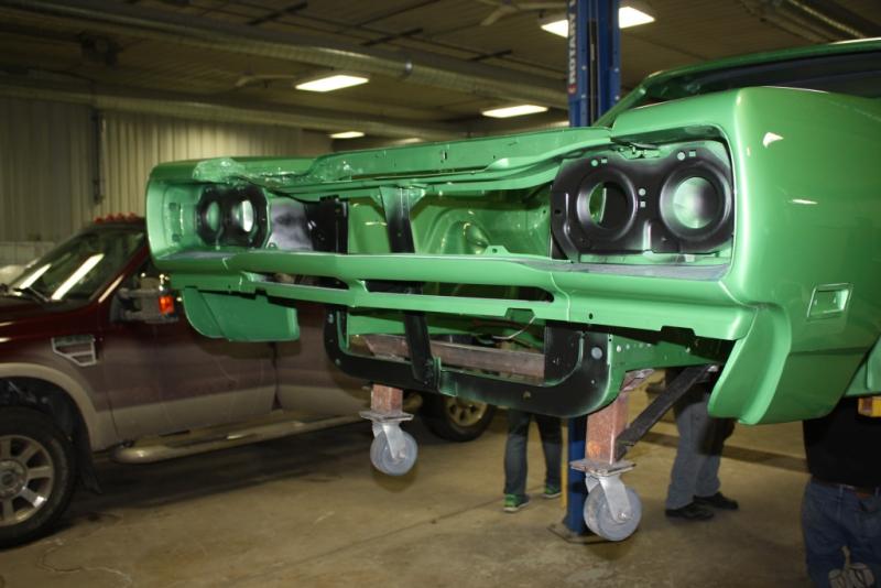

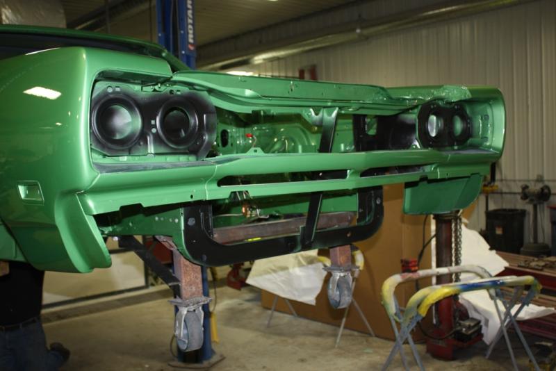

I agree with the comments made here. Nothing fancy done to apply. Just scuff the areas a bit and hit it with a rattle can. Here are some pictures of my Bee right after application. Hope this helps.
