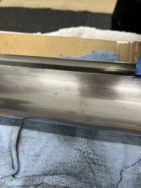

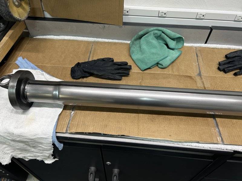

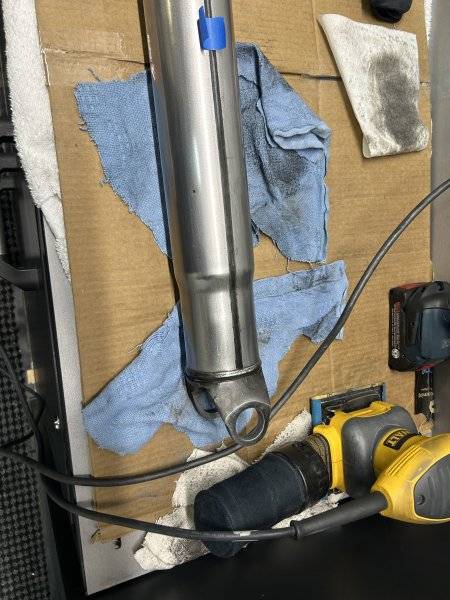

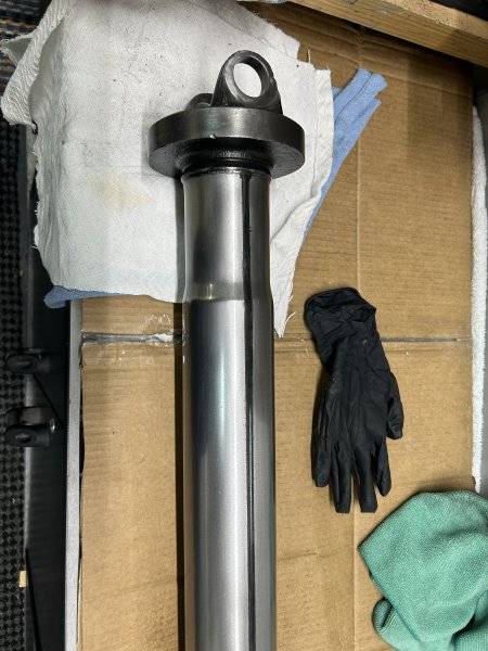

Pics are attached and show the resto results..

I wouldn't worry about any of those problems. Old doesn't mean it needs a re-balance.
Falling off of the bench didn't bend it, and you probably masaged it pretty evenly.
It looks beautiful. Run it!
If it doesn't vibrate, you're good to go.
Nice job
What process did you use to re-create the original weld burns?
I use black oxide when I did mine.

Thanks for the info guys! I used a Birchwood Casey Presto Mag Gun Blue to create the weld. I was also thinking of taking a torch to the end welds to create the burnt look but I am a little afraid..
