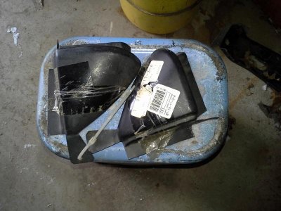

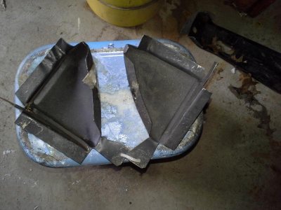

Anyone ever use Year One rear valance corners for a 1969 Charger?
I was wondering what type of quality they were, and do they match up to the quarters and rear valance?
I know AMD's corners are not great.
I found a pair for $100 shipped. And was wondering if this would be worth a try?
Thanks
I didn't use Y.O.'s Don, but are you sure that they aren't AMD parts? I did use current AMD corners on my Charger. Their corners were very, very close in comparison to my originals. The part that is not right is AMD's rear quarter in this area.
OOOooooh, the rear quarter is off!
So you sliced the corner to gap it corectly to the quarter thats not right.
Ok I feel better about buying these then.
And the guy told me they were Year One's. I would rather use AMD but these are 1/2 the cost. Just trying to save money when I can. I've got a LONG way to go!

No - we kept the corners intact and sliced the quarters. This seemed to be the consensus over on DDC also.

Thanks Hunt, I gues I better go back and look at your thread. Do you remember who else documented this in there thread?
