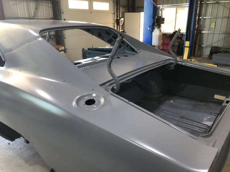

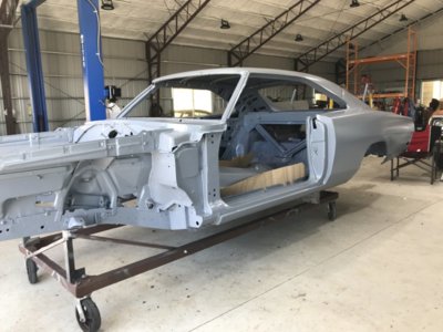

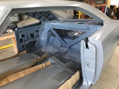

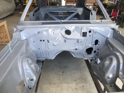

I'm restoring my 69 Charger and when I took the shell to be media blasted, I was told the shop would blast the car and then POWDERCOAT the whole car! I said "hold on I've been around the car hobby for 50 years and had never heard of such a thing". I told the shop owner he and my painter would have to talk about this. They talked it over and my painter said he liked what he was told and that the shop had been doing the powder coat as a sealer for a couple of years. I'll let you know how it goes.

The car was stripped to bare metal with a fine grain metal media. Next a thin coat of powder was applied and then the car went into the oven set at 400 degs for ten minuets. The reason for the powder coat was to stop rust from forming. I can take all the time I need to get the body work and paint done. Also, the powder coat MUST be sanded with a 330 -350 grit sandpaper to give the primer/paint a mechanical bond with the powder coat. The gloss must be removed from the powder coat wherever paint will be applied. No part numbers or VIN numbers were covered up by the powder coat.
