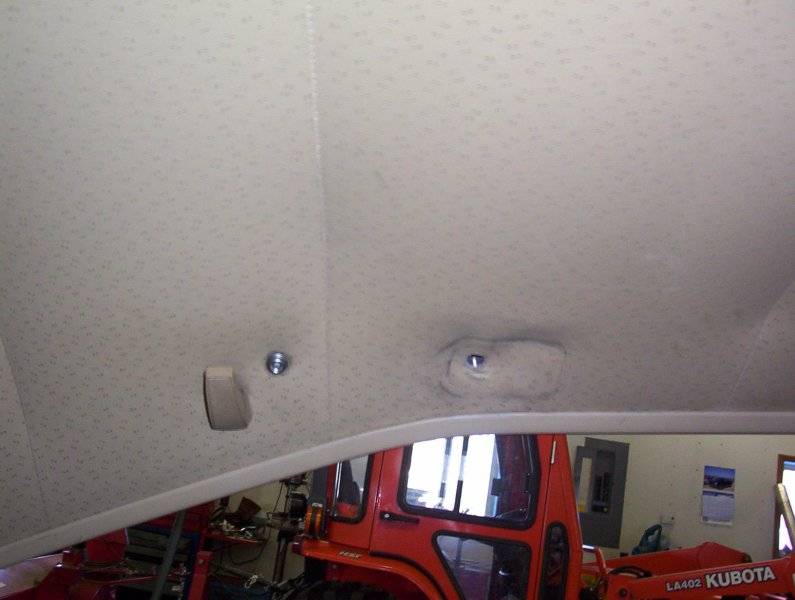

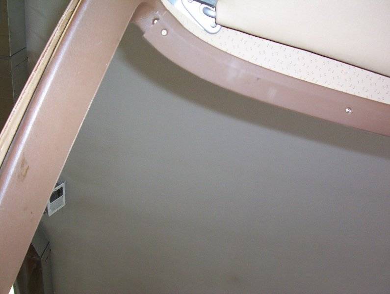

They were two different colors. The upper windshield one was more like the upper door pad color. The A pillars were also that color. The side roof trim was a soft beige color like the headliner.

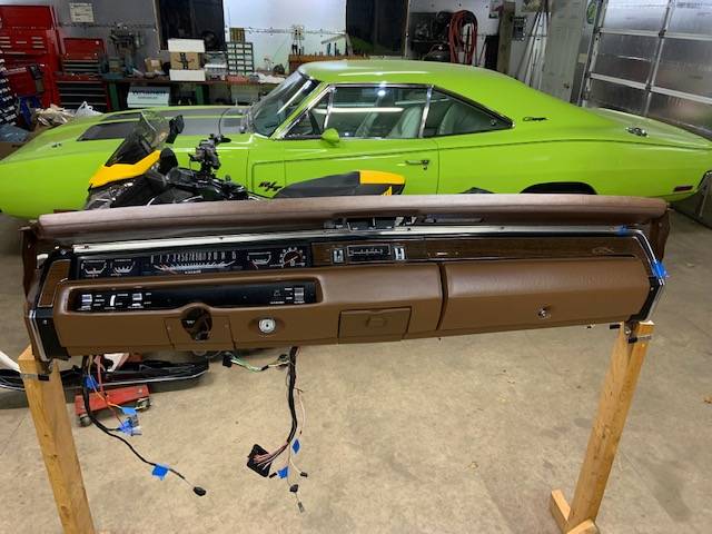

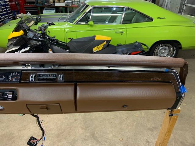

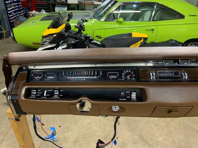

I recently restored a 69 GTX dash and had my tan dyes mixed at a local finishmaster. They color matched the original parts from areas that were not exposed to UV.
The textured suede lacquer is very close in color to the vinyl dye. There are some differences in real life verus photos.
