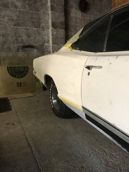

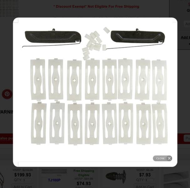

hey everyone, I have a 69 Coronet 500 and I need to put the trim piece back on the quarters after they were patched but the ones I ordered from CI are too long for the trim piece, they said they don’t have the ones I need, does anyone know where I can get them? I don’t have a pic of the trim and exact size right now but I’ll post some more pix tonight. Here’s a pic of the trim on the front of the car and the kind of clips I got from CI, any help is greatly appreciated thank you in advance!

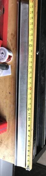

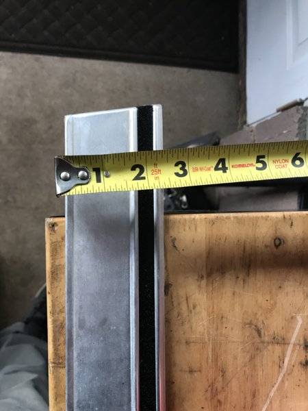

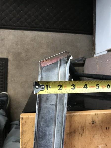

Here are some close up pics of the trim piece I need clips for with a measuring tape for scale. If anyone knows the correct part and where to buy it I would really appreciate the help, thanks again the clips I posted are the ones I bought but were too big, thanks in advance

seller claims this will work, these are designed so you trim the ends to fit as long as the center post is the right diameter it should work... Not "correct" but who sees it?

They fit into the quarter panel no problem, I put them all on before realizing they were the wrong size. but they’re about a half inch longer than the trim is and were already returned to CI

Thing is you cut/trim them to fit the molding and attach them to the molding before inserting them in the holes on the body.... obviously you need to slide them into the proper alignment before installing the trim...

Thanks for the link, I saw a similar set on eBay that may work, but wasn’t aware u trim to fit, I may try them out. Thank you
