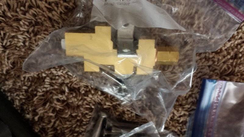

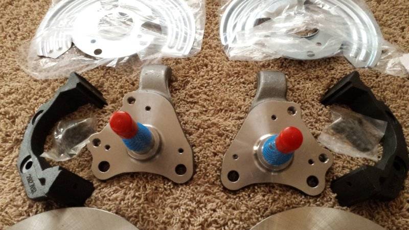

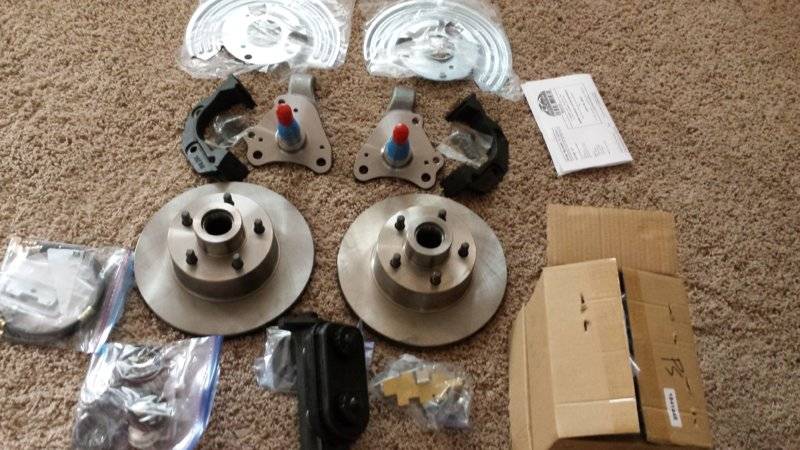

Unless you are road racing or autocrossing I think the 4 wheel disc is overkill imho. Stopping force is primarily on the fronts. Here is the complete kit and I want to say it was a little over $700 complete.
View attachment 590154 View attachment 590155 View attachment 590156 View attachment 590157 View attachment 590158

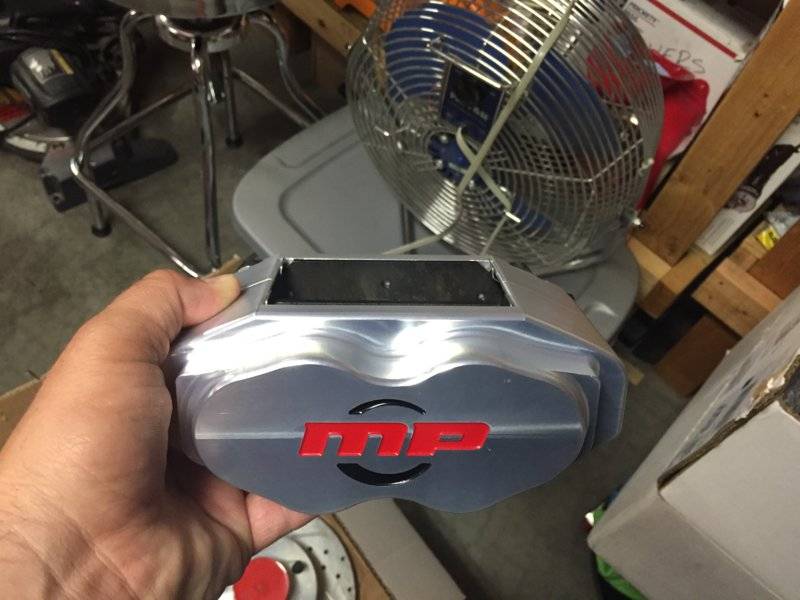

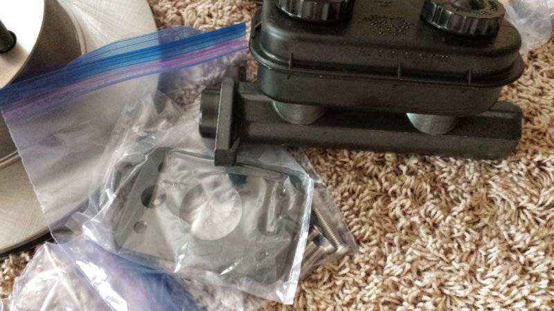

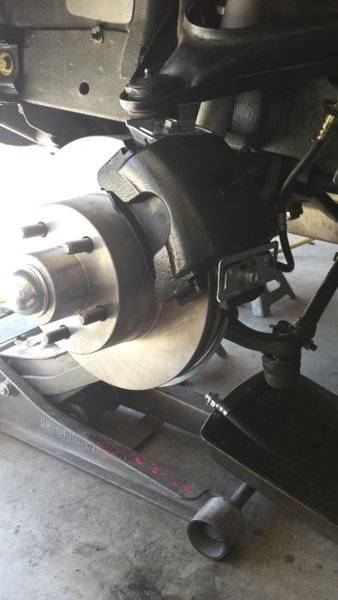

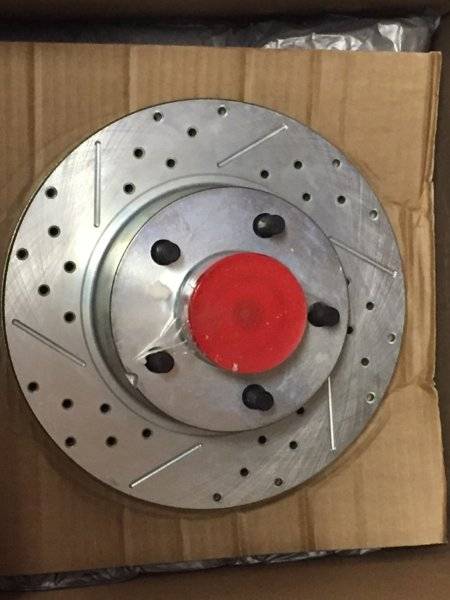

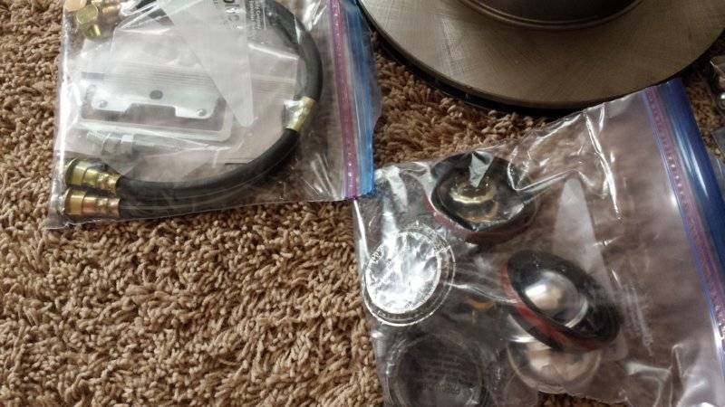

I wanted a simple kit as well that fit 15”. I knew several mustang people that used masterpower for brake conversions and theirs seemed like an all in one kit even with bearings greased and installed in the hub. I got their rally series and it all looks like good quality. Maybe a little pricey over some others but I did choose the made in USA billet aluminum caliper kit. I haven’t installed yet but am hoping to this spring so I can’t say one way or the other on how they are. Anyway just another option to check out.
https://www.mpbrakes.com/front-brak...nt.asp?catid=A13D4A4FA57B4B5ABA6056F85CA78C5B
FABF5F02-B15D-4D68-94BD-D384DC827841.jpeg 2943A542-E52A-46A2-8F05-C7467B2F07E7.jpeg
Yes, you need to swap the master cylinder and distribution block. Driver side took me 2 hours, no issues and fits like a glove.

The Masterpower looks exactly like the SSBC kit. Prob made by the same manufacturer. Compare prices.
